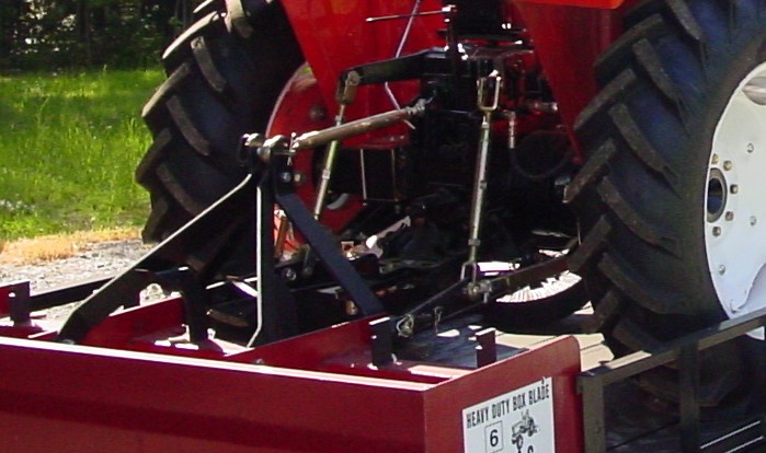

Hi,
My procedure to tilt the box blade for the road crown is very scientific /forums/images/graemlins/grin.gif /forums/images/graemlins/grin.gif /forums/images/graemlins/grin.gif....
Can't remember the name of the links that go from the upper lift arms to the lower 3PH arms - showing my newbieness here - so I attached a pic - they are the "brass" looking links connecting the upper and lower arms.
I attach the box blade, go to the driveway where it's level and put a brick, yes a regular ol' brick under the left side of the box blade. I then lower the box blade and adjust the link on the left side so that I get the 3" of tilt on the left side. This usually takes a couple of attempts to lower as there is not 3" of play between the arms. To level the arms back, I remove the box blade, go to the driveway and put a level between the arms and adjust the left side.
I don't tilt the blade every time I scrape; probably every other or every third time. Typically, just following the existing crown. I don’t ever scrape down the middle, just on the sides and always in the same direction – “up” the road on the right and “down” on the left side whether the blade is tilted or not.
Some of the more experienced guys here can give better advice and an easier way I am sure. This is the easiest I have found - especially after the first time when I tried to adjust blade hanging in the air - I learn my lessons the hard way /forums/images/graemlins/tongue.gif /forums/images/graemlins/crazy.gif /forums/images/graemlins/confused.gif
