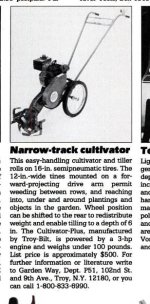

I have a 30 year old Troybilt Cultivator Plus. I don't have any of my own pictures of it, but attached are some pictures I found on line. I have two of the mini Hondas but I like this better for getting up close to rows in the vegetable garden. The Hondas jump around, this does not. In a flower garden with less of a "row" the mini Hondas work well. I put agricultural fabric under anything that spreads horizontally (potatoes, pumpkins, squash, cabbage, broccoli, cauliflower, etc.). I burn holes in the fabric with a hand torch where I plant. I reuse the fabric from year to year, makes for less weeding.
