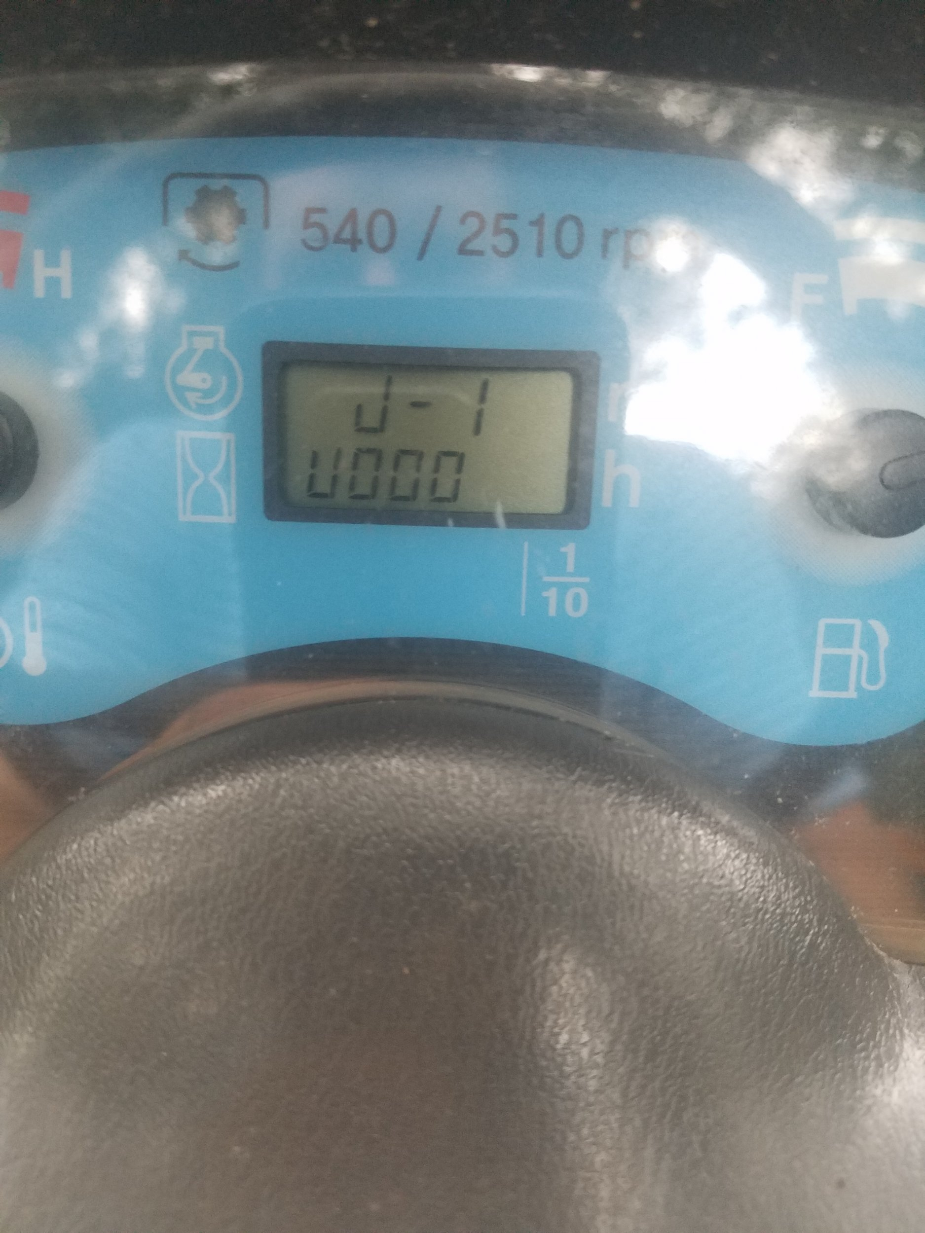

Today I hit 50 hours. Now I an getting the above code every time I start the tractor. Is is a reminder code that service is due? If so will it rest once I do the oil and filters?

It’s a long time ago. Did you find the culprit? Have same code.

I have the code too. Mine is j-1 and under it is almost like a U and then 000. Key wont even turn the instruments on. I know I accidentally tried to engage the pto right quick to turn it a little and that shut it down and left me with that error. Anyone know how to reset what seems to be a safety lock out

Every now and then it let's me try to start and instantly everything shuts off and wont respond anymore. Then after a few minutes I'll randomly hear the glow plug clicking sound and see the all 8888 and the the j-1 error and then it goes back to being unresponsive. No key on, no lights, nothing works,

Well I let it sit for a couple of days and decided to give it another shot this morning. When i went to turn the key on, now the PTO switch light was on and i was able to switch it to the off position easily. Not sure why I couldn't get it to switch off the last time but it definitely wasn't an option to turn it off mechanically.
