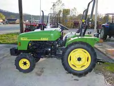

   / What is a Task Master Tractor ? #7
Here it is: (see attachment)

The information about Dongfeng is the builder of Task Master is correct, the quality is not! Task Master is a chinese tractor probably equal to Jinma, Kama, etc., however it is not even close to the Korean tractors in quality. I bought a Task Master a couple years ago and I can tell you that the fit and finish were not nearly as good as Lenar.
