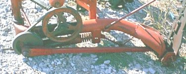

I got to ask, what is a pitman mower?
The pitman mower is the ones with the wooden drive stick that attaches to the sickle head. Ford 501, Massey #32, John Deere #9 and 39 are common examples. They have limited movement in the cutterbar angles they can mow. About 35 degrees above and below horizontal. Ken Sweet
They say a pictures is worth a thousand words. Here are examples of both. The one on the left is a pitman style Ford 501 and the crankshaft is on the left with power transferred through the wooden pitman to the sickle head. (limited up and down blade movement) The picture on the right is a typical belt drive setup where the crankshaft is on the right at the beginning of the sickle cutter head. Ken Sweet
