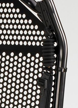

Seat belt comfort system BM 22076

The overhead panel IS included with the Deluxe Cab. The Electrical Kit (VGB10505) is NOT included and is REQUIRED to install ANY and ALL electrical accessories. The Interior Light Kit (VGB10539) is NOT included. The OPS Comfort Relief System (BM22076) was designed for the "OPS" (Operator Protection System) which is the standard ROPS structure included with all HPX and XUV Gators. I do not know if it will fit the Deluxe Cab System.

As far as the switches go, they do install into the overhead panel and one switch would control both of the front lights that are included in the Front Work Light Kit. I have included some pictures below for your viewing pleasure!

Thanks for the pix. The last one is exactly what I wanted to see. No dealer in my area has had a deluxe cab frame in months for me to look at. I saw one last summer and it had all the glass on it. I didn't pay attention to the light panel at the time.
