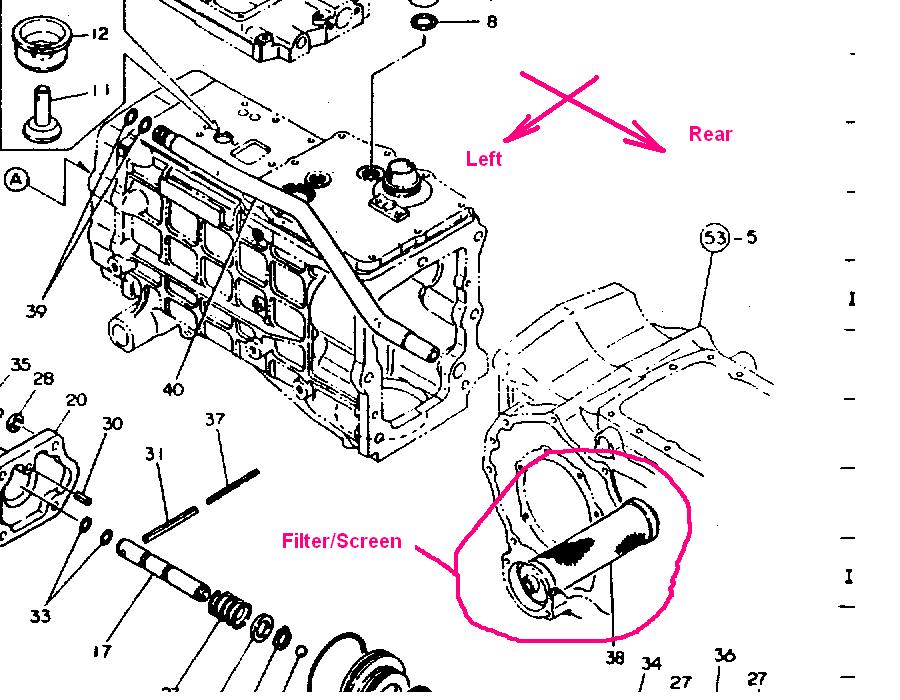

   / What is that high-pitched noise when I try to lift something too heavy with the 3pt? #9
Re: What is that high-pitched noise when I try to lift something too heavy with the 3pt?
dieselfuelonly said:
1. What fluid should I replace it with? Does the same fluid that runs my hydrauilcs also work in the transmission? I only see one resivoir, so thats my guess, but I'm not positive.
Any transmission/hydraulic fluid which meets JD303 specification. Check the fluid container to verify that specification is listed before purchase.
2. Where might this filter and screen be?
Description specific to my tractor, is probably similar for yours: It's a cylindrical filter that installs transverse to the sump. It's behind a circular cover plate on the left side of the sump forward of and below the rear axle. See the attachment for the location on my tractor.
3. ... will I have to drain all the fluid anyway in order to clean the filter?
Yes.
   / What is that high-pitched noise when I try to lift something too heavy with the 3pt? #10
Mine was doing the same thing. As Ernie said your pump is starving for fluid.
I just serviced the transmission on my 1610D this past Sunday. It is an easy job. You will need a oil pan the holds about 4 gallons to drain into and some gasket sealer to put on the edge of the cover when you go back together other than that it is as easy as changing the oil in your car. The screen can be cleaned with a soft brush and some diesel or carb cleaner. Mine was fairly clean and I have out almost 90 hours on my unit so far.
The transmission sump on mine has 2 drains one in the middler and one right under the filter cavity. Make sure you drain the both, I did not see the second one until I had already pulled the filter out of the tranmission.
Even though my screen was not dirty the system quit squealing after I changed the oil and refilled so I must have been a little low or there some blockage that I did not see.
