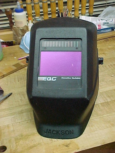

Shade 14 UV protection at all times is something I didn't know. That makes me feel better about the microflash exposure you can get with an autodarkening helmet. Although, if you close your eyes for a second as you strike the arc, you have no microflash.
Because I couldn't remember, I checked which brand I have. It's a Jackson EQC Executive model. It was the only large lense autodarkening helmet my local welding store had at the time (3 yrs. ago).
I believe this <font color=red>https://www.securewebexchange.com/probuy1.com/WeldingProducts/products/0752-0201EQC.asp>link</font shows the current version of my helmet. At the website, do an item search for Jackson Welding Helmets to see the multitude of variations.

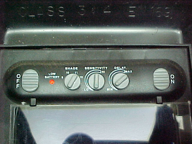

This is a snapshot of the controls inside the helmet.
The two main options to consider regardless of brand are lense size (small or large) and shade (fixed or variable). Some have a solar (light from the welding arc?) component which saves battery life.
I am only an occassional welder, but the original batteries are still in my helmet and seem to be working fine. I have no idea where my helmet runs in a cost or quality comparison, but I have been happy with it so far.

OkieG-
That looks like the inside of my HTP helmet. /w3tcompact/icons/wink.gif

Hey Ranchman, good to hear from you.
I wonder if more than one helmet manufacturer gets their lense mechanism from the same source? I guess several brands cculd use the same lenses.

OkieG-
I suspect you're right about the lenses. /w3tcompact/icons/wink.gif
