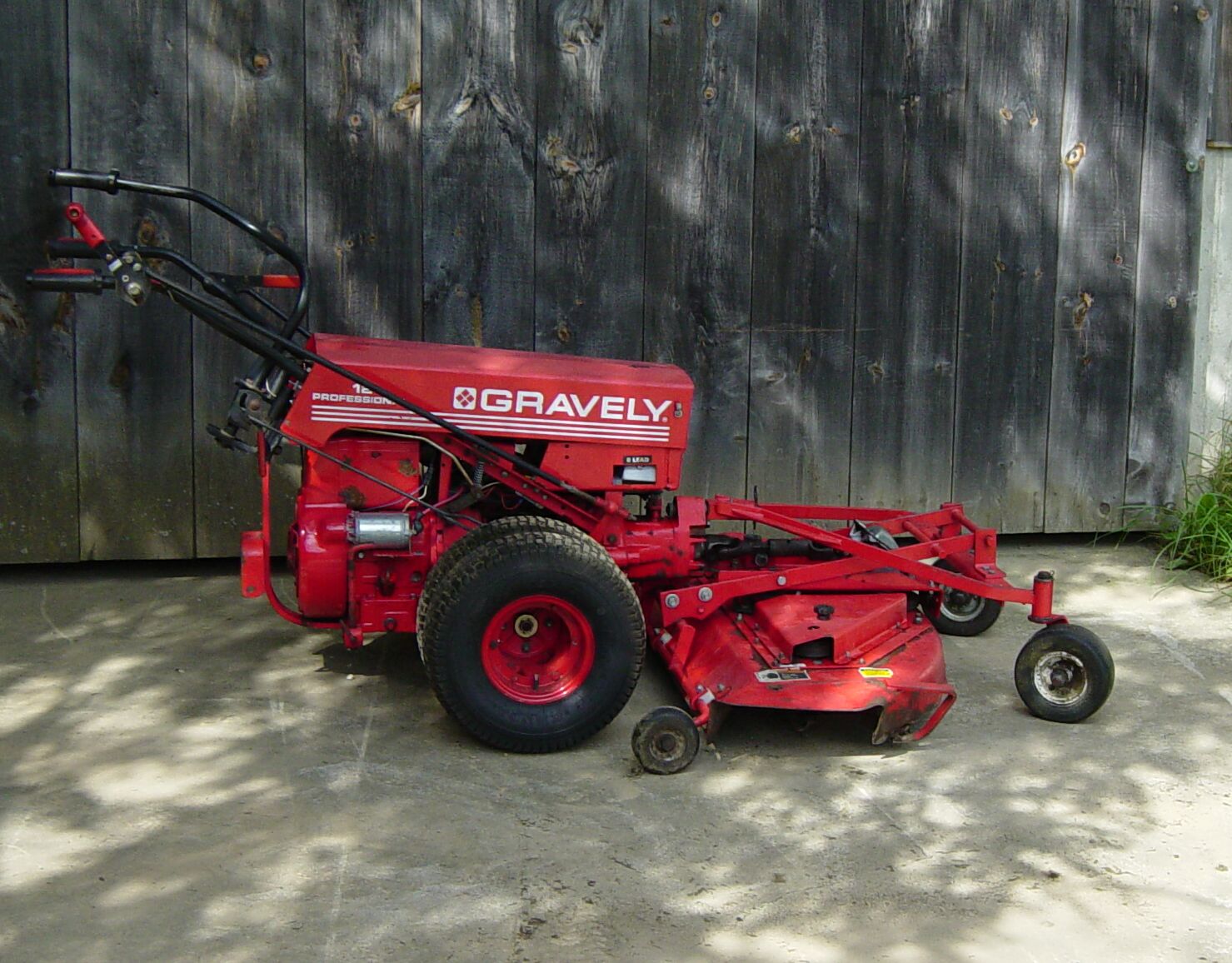

I am looking to purchase a gravely 2 wheel tractor. Its primary use will be brush mowing on slopes too steep for a 4 wheel tractor. I had considered a BCS type tractor but cannot afford one at this time and used ones in my area are rare. Lots of gravely though, many with several additional attachments. I have been reading and researching and am having trouble finding out which is the best model gravely 2 wheel tractor to seek out. It seems like the L8 was the best of the L models because of the transmission, but I havent seen info on how it compares to the many later models. Is the L8 the king of the hill? Or should i be looking for a different model and why? Thank you!

I had this Pro 12. It cut the grass around the house better then anything I have owned (and that's a lot).
But it was very heavy and although I got the adapter to use the old style attachments, the machine was just too cumbersome.
