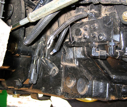

Like Jim & Roy, I usually just backed over them. Of course you can drive the tractor over them and let the rotary cutter then get them and that usually works just fine. The one thing to remember if you do that and you decide to stop and back up without having gone all the way through, is that some of those limbs that sprung back up under the tractor may snag something like electrical wiring and/or hydraulic hoses on the bottom of the tractor.

I echo the concern about driving over them. I did that a lot and eventually one of the saplings caught a wire under the tractor and it happened to be a wire that had something to do with the PTO, because it stopped dead. Unfortunately it was a couple of wires and I couldn't figure out what went with what end and didn't want to guess. (see attached photo I took to show the maintenance folks at the dealer). I'm now a fan of either backing over them or trying to dig them out with the toothbar on the FEL (much easier after a rain).
