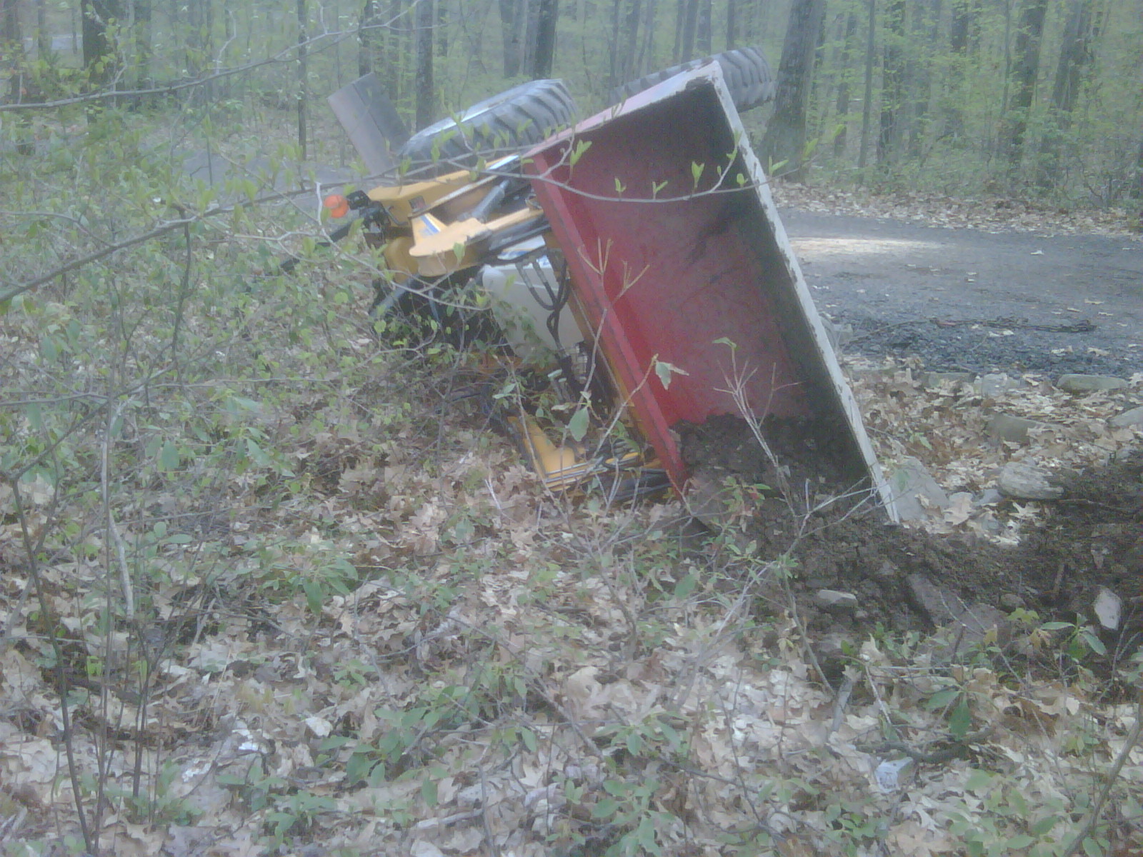

I had a 1999 Cub Cadet 7305 which was a Mit. clone to the Mahindra used it right up until last winter when I sold it to one of my employies and at the time of the sale it has just over 1,400 hours on it now it has close to 1,800 hours and survived this....(see picture below)
I NEVER had a problem that was not an operator inflected issue, now I'm not saying you or any one else will never have any problems just saying with dedicated maintance things can last a long time.
