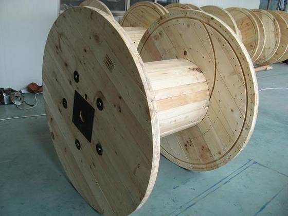

We just found a good deal on an old John Deere 200 hay elevator but can't find a manual on-line without buying one. I just need to know what the max angle it should be set up at. Just loaded about 100 bails the other night but had problems with some falling backwards (3' square bails). From where we had it setup, it was about 9 feet up to the loft, and it is a 16 foot long unit so about 35 degrees. The bails where tied pretty loose, and the frame is a bit beat up that I am going to try and straighten it out, but wanted to know if I will have to raise it up more to get the angle down. Have another 300 bails to go in the next couple weeks and don't want to be fighting them the whole time.

We used to have this problem regularly. These are the ideas that help. I assume you are unloading off of a hay rack or similar. We would set the bottom end up on a barrel so that the angle was less. Also slow the elevator down as much as practical. If you can place the bales one behind the other then they tend to ride up better.
   / What is the operating angle for a hay elevator #5
Wooden_Cable_Reel.jpg we put ours on wire reels
