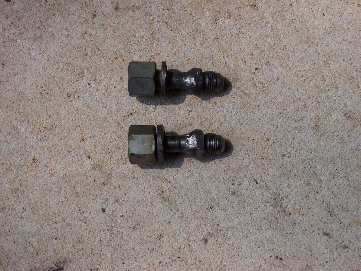

I have always Oxy-Acetylene welded or brazed steel lines that have failed. TIG is also more friendly and it is similar to gas welding. Both give you a lot better control of the puddle.
Pic is adapters that I had to make because I could not match up Chinese flat face fitting on a Jinma Hoe.
I gas welded original FF to a JIC fitting.
