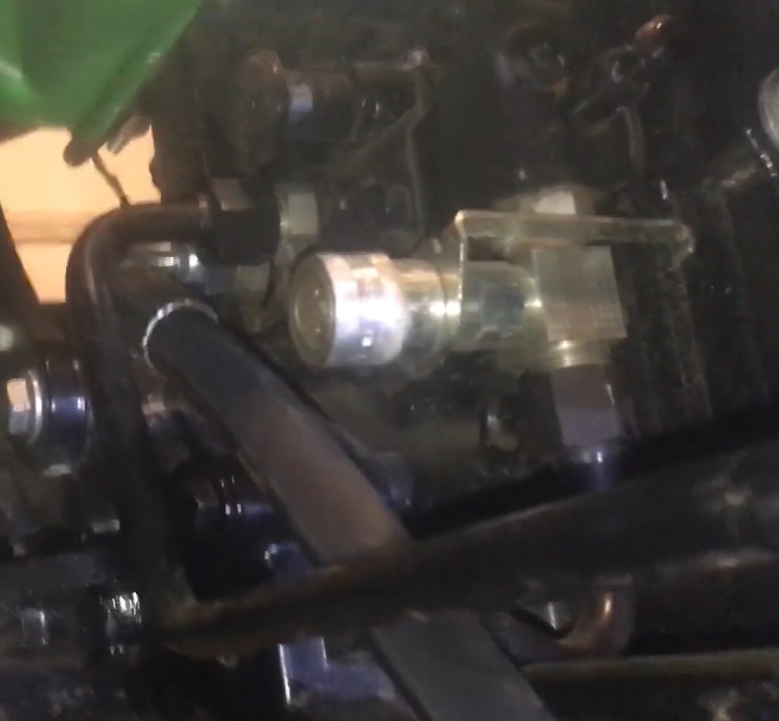

New tractor owner here. I have a 3038e that I bought new last year and am wondering that the coupler in the photo is used for. I could not find any reference in it in the manual. The coupler is located underneath on the right rear side of the tractor.

Another view of the coupler (not my tractor in this photo)

It looks like it's Tee'd off a valve--Perhaps power beyond. It may be for auxiliary/remotes or simply a test port. Without additional parts, I would guess a test port.

What SCV controls do you have? A pic of the controls might help.

What does the steel line service that the coupler is in?

Connect a pressure gauge to it and see what SCV controls it and what pressure you get.

The Parts List says the black oil pipe is "Oil Line - Implement Pump to RCV Manifold"
That 'RCV' is the Rockshaft Control Valve that the flange fitting screws into the bottom of.
The coupler looks to be a standard QC-type so I doubt it's a Test Port.
There is shown a "Cap" which fits over it with a Service Reminder sticker.
I'd think the 'Cap is a Dust Cap and you should get one to keep the QC clean.
Part Number LVU35060 (Less than US$5.00)
The sticker is Part Number LVU35065 (Service Label. RH) and is more expensive than the Dust Cap. (Less than US$10)
Do let us know what your dealer advises the port is for, thanks.

That is intended for diagnostic testing only. You can measure system relief pressure there. There is no function of it mentioned in owners manual.
