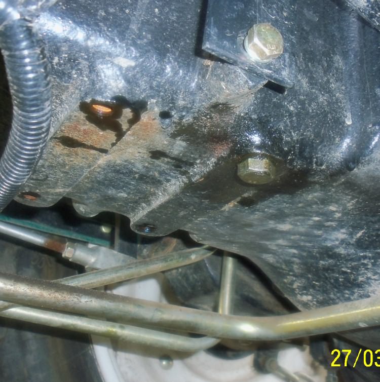

Do you have a loader? If not the 4 holes on the bottom of the bell housing are for the loader mount. I can not explain what the gunk is or why they are not tapped.

The holes are directly under the tranny, not under the bell housing. I do have a front end loader, but it mounts much further towards the front of the machine.
I am going to take some of the bolts off the other side, and see if they fit, then go get some replacements.

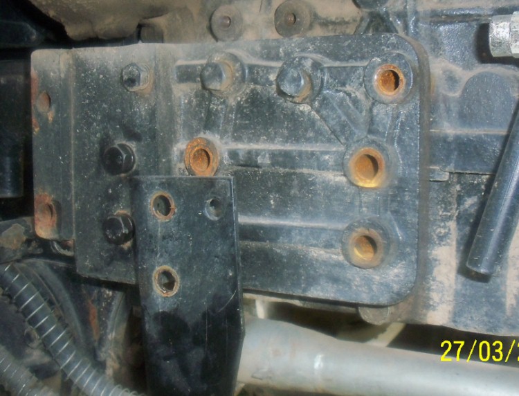

See if I can post a picture. This is the bottom of my trans. The one bolt. Has some fluid from me removing the bolt and poking at the goo plug inside trying to figure out what was going on there. The other holes are blind.
   / What is this? JM 354 questions
The missing bolt holes. And the opposite side with the bolts in place.

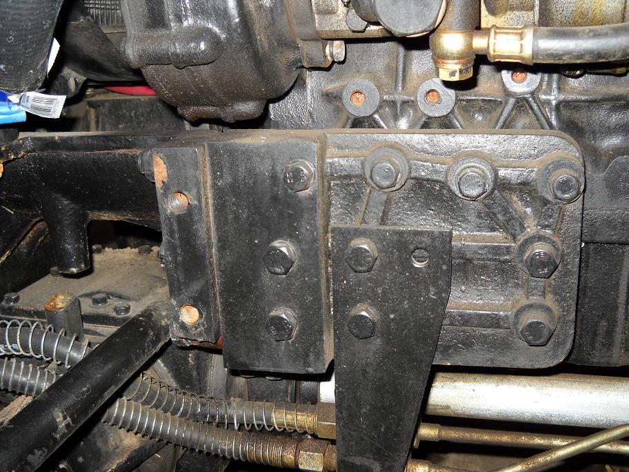

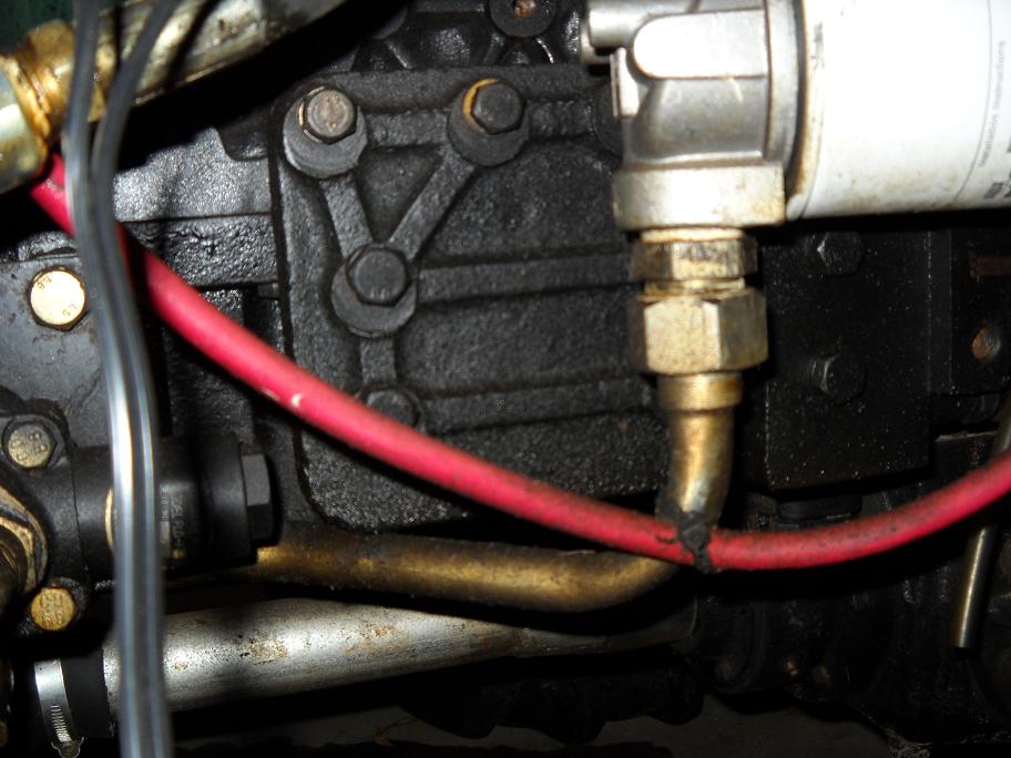

Sorry it took so long, but here's pictures of my 354.

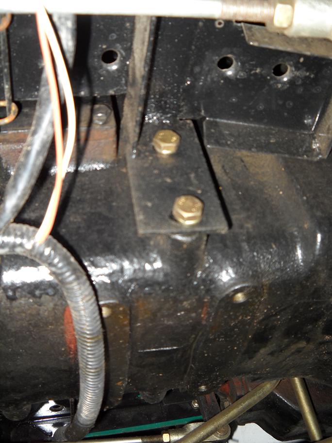

By the way, here's underneath the tranny, all the holes appear threaded. Maybe they're just for bolting to something during shipment from the transmission factory to the tractor factory, I don't know. There's no bolts in mine, maybe your bubblegum theory is correct.

OK, here's my two cents worth.
On the underside of the transmission, the four holes are clearly mounting bosses. I will speculate that they are for mounting: 1) An intermediate U-joint and pillow bearing for front or mid mounted rotating implements driven from a rear drop box on the PTO. 2) A mounting for a mid-mounted grader blade or belly mower. Since the tractor was not ordered with any of those options, the holes were not tapped.
The side covers could possibly be PTO mounting points if they are on the transmission case.
Curious if your tractor was purchased new from a dealer that properly prepped it?

Bob, the side covers are near the front of the engine, note in the first picture I posted the injection pump mounting just above the plate. I know from googling around that these engines are popular for generators and marine use, it may be related to those uses.
As for your theory of mounting bosses for some implement related purpose, that sure sounds plausible to me. Or maybe they're used in some application with a frame?
