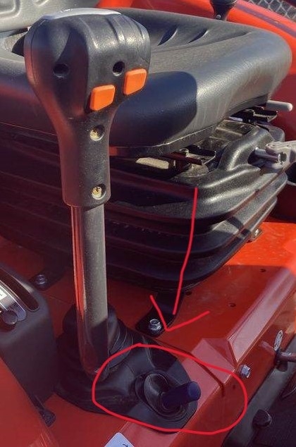

At the bottom of my front loader joystick is a small lever that I cannot find any information about. Anyone have an idea what this is for? Thanks.
As noted below it is the "joystick lock lever" so the the loader cannot be moved.

As above . . . That locks the joystick so it won't operate the valve. Can't be moved.

Well that was a waste of my first post on this forum. After posting I finally found it in the manual. I swear I have looked forever. Yes, It is the joystick lock lever. Thanks all.

Just know that it will not prevent the loader from falling down if a line bursts.
