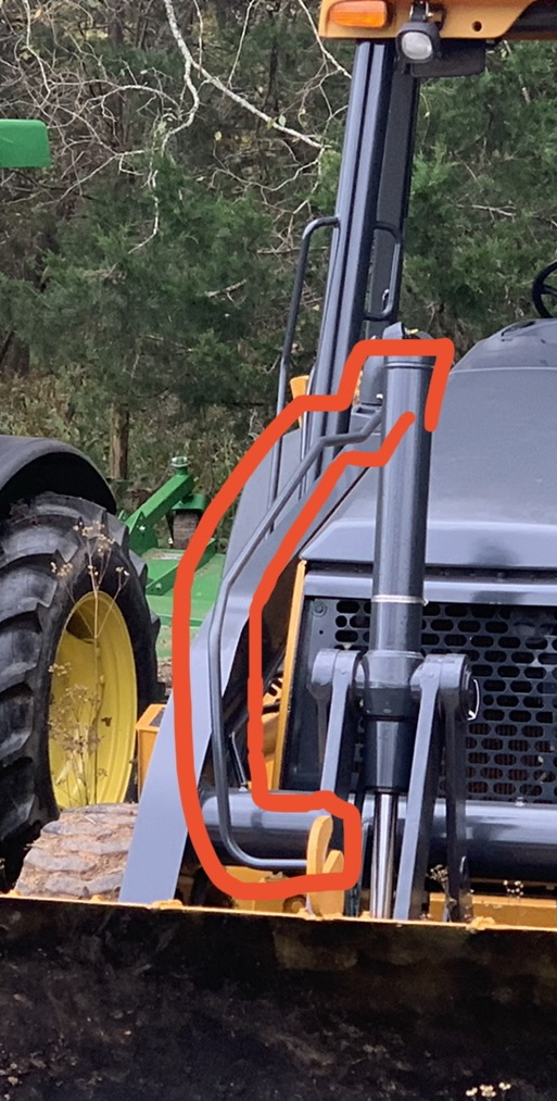

Hello everyone, can you folks assist me in identifying this part?
I ran through some trees and this bar came loose in the front section where it attaches to the links holding the loader bucket. Can't really tell what it does....? Hold the hood in place maybe?
I need to reconnect it somehow but the end is basically flush with the hole that appears to hold some bolt that must have fallen off.
If anyone has a picture of how it is supposed to be connected, that would be useful too. Thanks!

Looks like the bucket leveling / return to dig linkage
