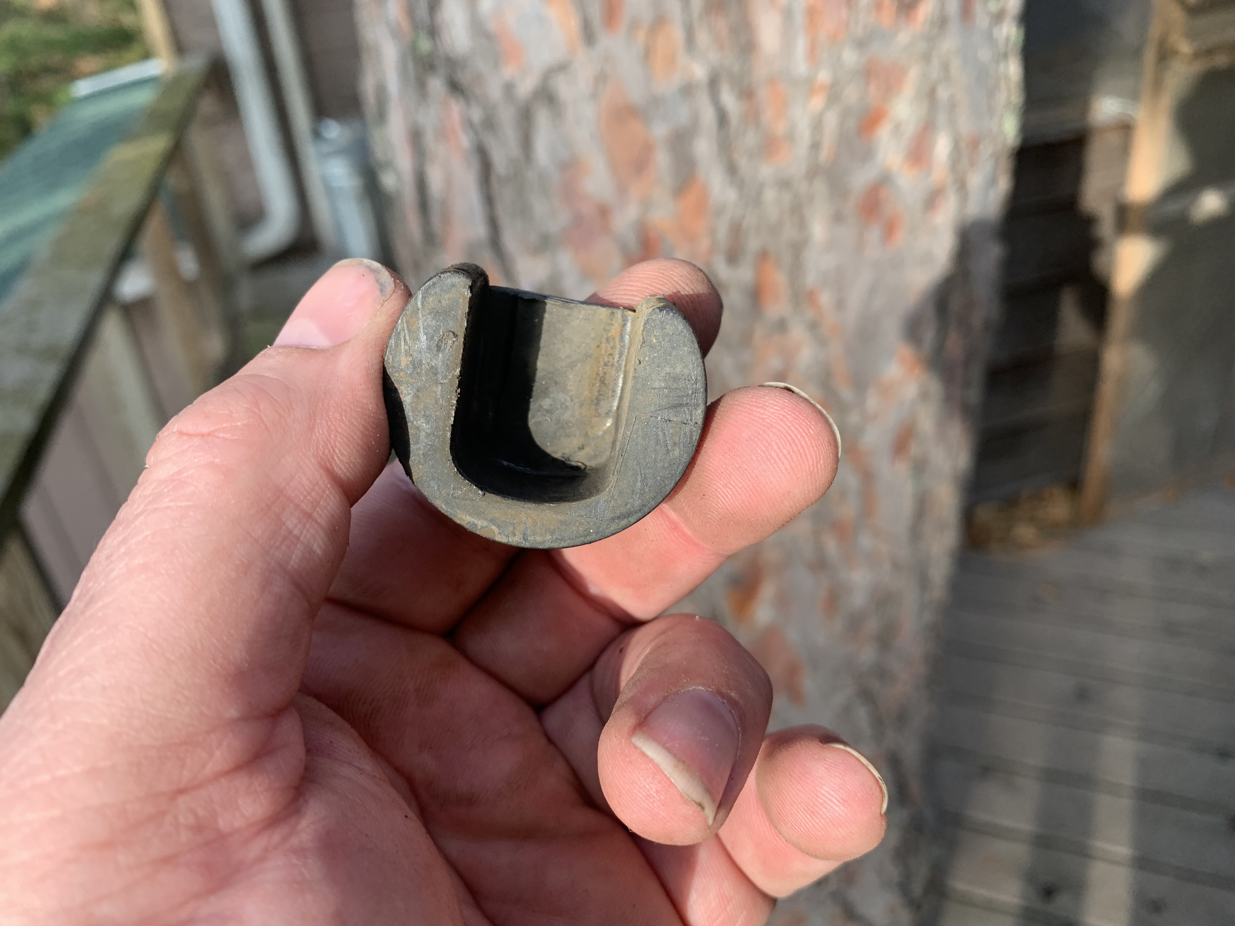

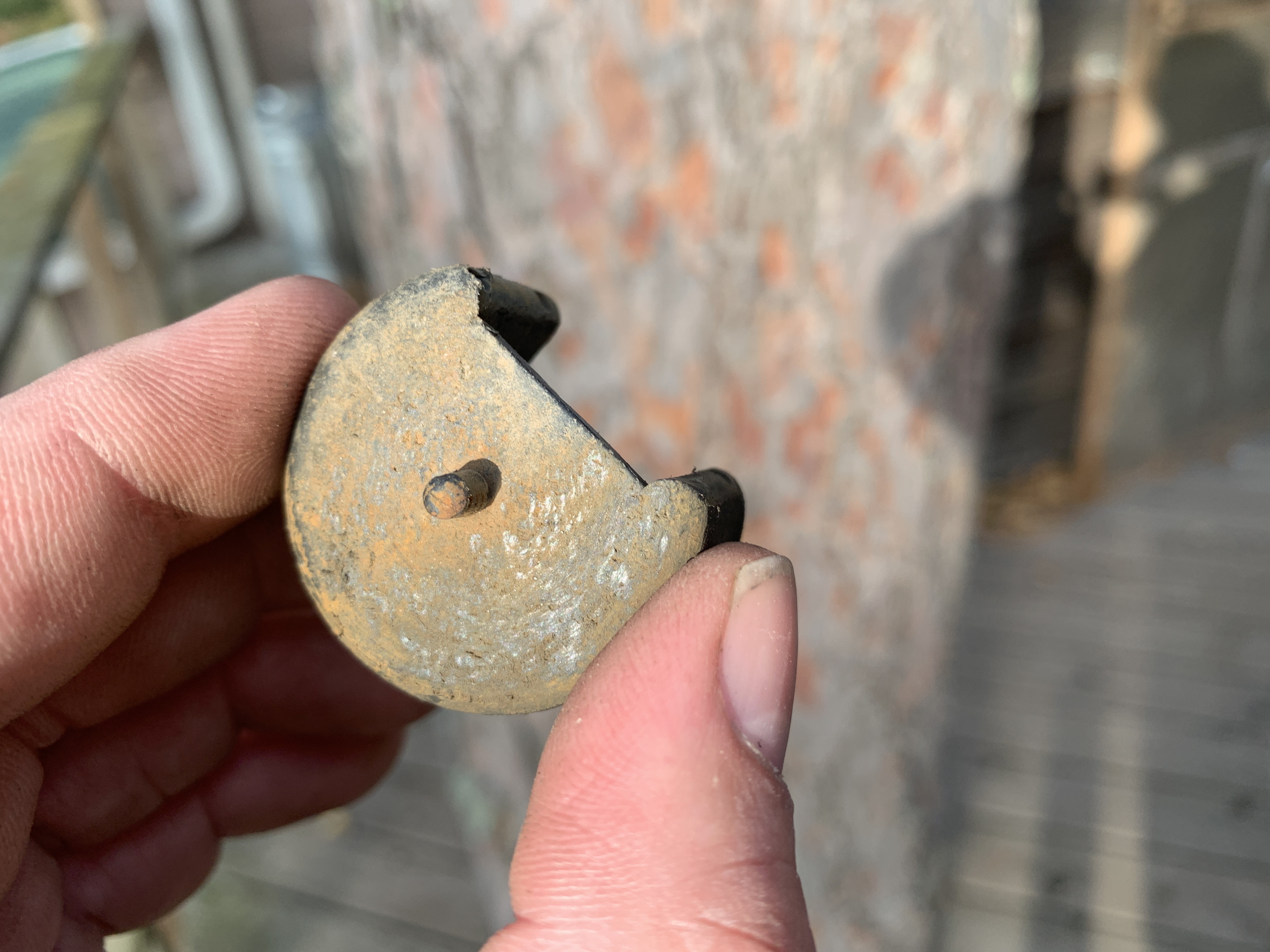

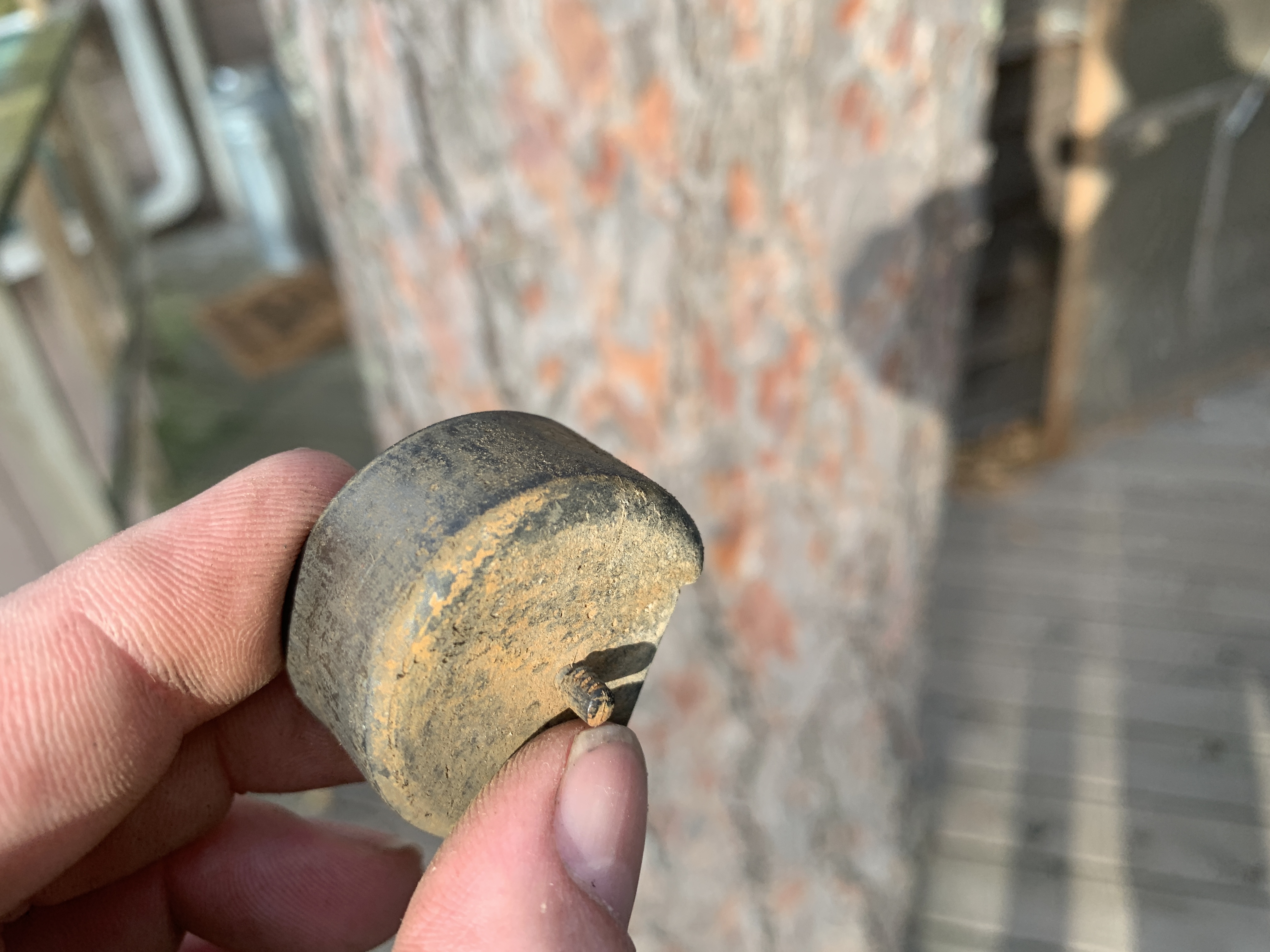

I found this near my tractor. It is some kind of bushing but I don't recognize it. Anybody know?

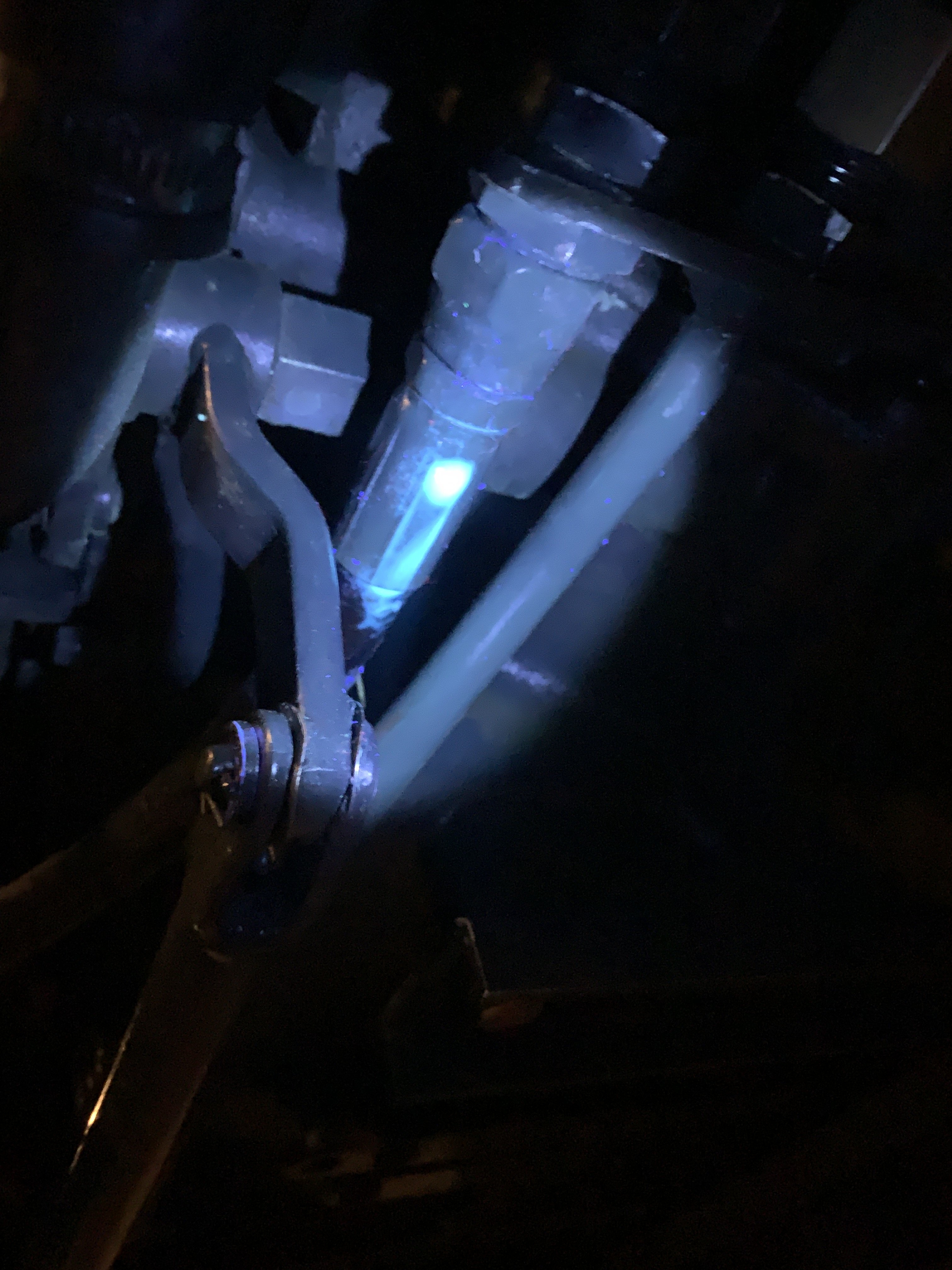

Also I'm starting to understand why I couldn't identify my hydro leak without using UV dye and a blacklight. Fired my tractor up and noticed a drip right about where there hardline drip I just fixed was. This time it is a bad crimp on a soft line that comes from the gear pump's other hardline (undoubtedly with another undocumented 0-ring) to the joystick valve. Swapping this one out will be much easier!
