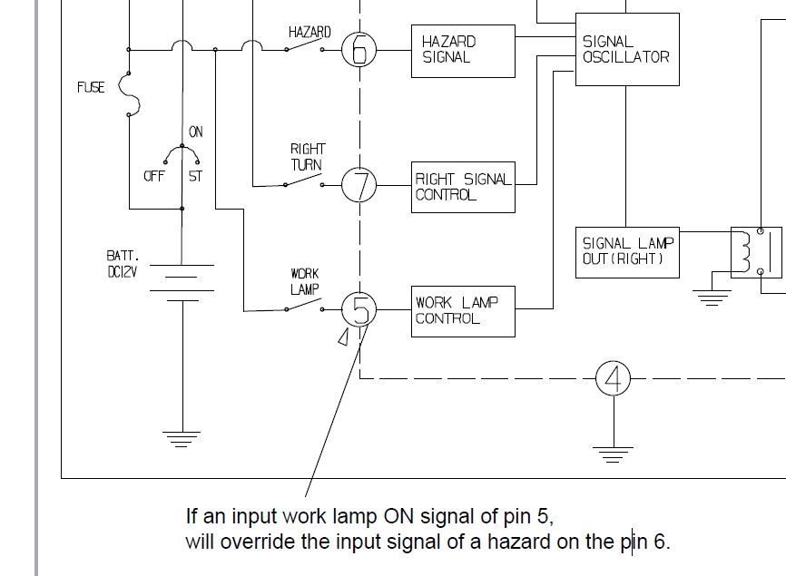

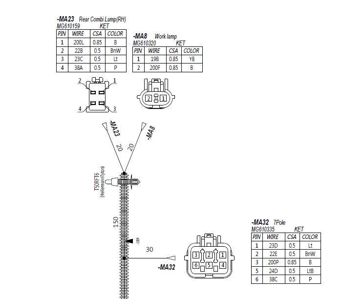

/ What is this plug? #12
Wow .... umm.. I forgot I had one. Dealer gave me a thumbdrive and I never really looked at it before. Guess what it's for. Nyuk, nyuk, nyuk ....
No idea where the switch shown in the schematic might be though.
Edit ... Not a switch. Those are the relay contacts shown. Still can't find out how that plug is turned on or off.

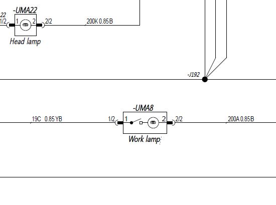

'Nother Edit ...
Looks like it's just 'hot' when the key is on and uses an integrated switch in the lamp assembly:
/ What is this plug? #13
Reading further, I also have a complete parts manual with exploded diagrams. It shows the work lamp assembly with the mating connector.
/ What is this plug? #14
Mine is a standard SAE hot plug. I use it to power the rear work/flood light.
