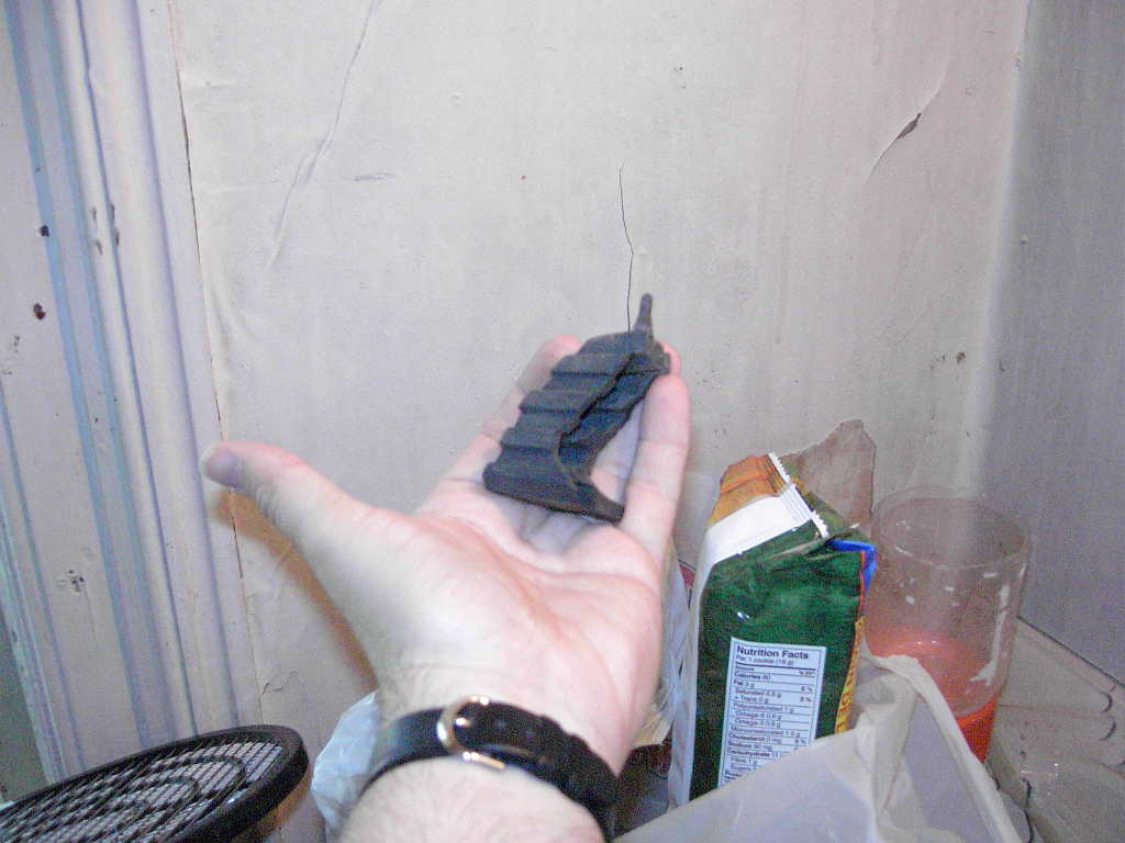

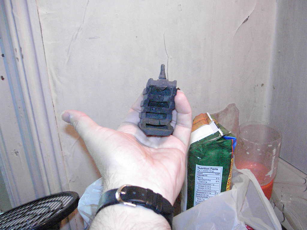

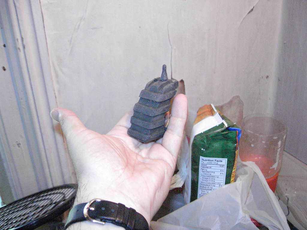

I've been doing a lot of earth moving near my house lately with my GC2310, and my Case 680.
This morning I found a piece of rubber on the ground where I've been driving with these two machines. I'm fairly sure that the rubber piece is not off of my 40 year old Case 680, so it must have fallen off my GC2310.
Any idea where it came from, so I can put it back?

That is the rubber that is commonly used to hold a radiator or condenser in place, on a vehicle's coresupport. It fits in a spot at the bottom, and the part that comes to a point is pulled through a round hole, which locates the rubber and holds it in place during installation.
I do not recognize that particular one to say what vehicle it is off of, but I would bet money it is not off your tractor. The 2300/2310 series does not use that type of rubber on their radiators. and, I don't know where else they would have used such a thing.
