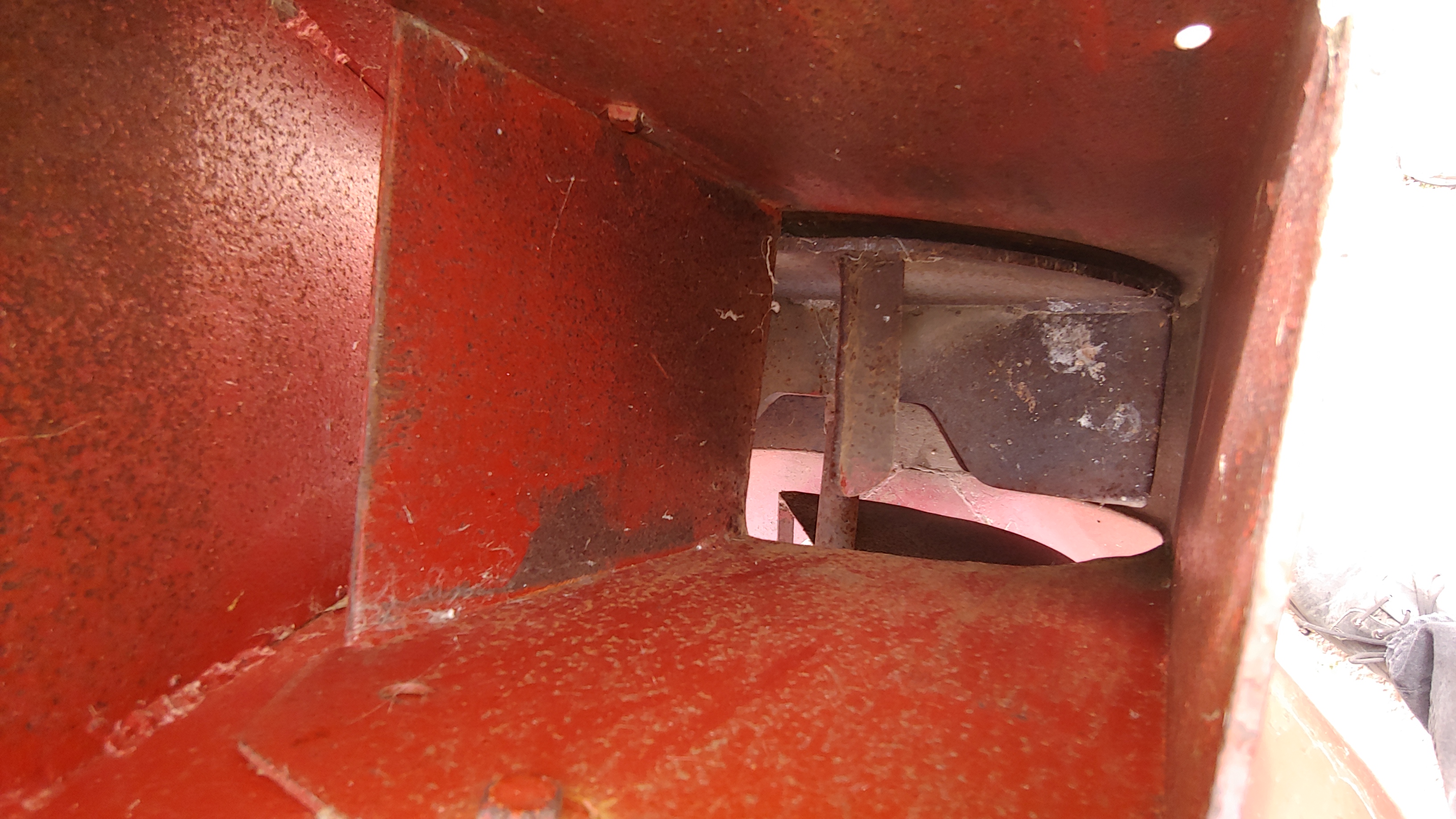

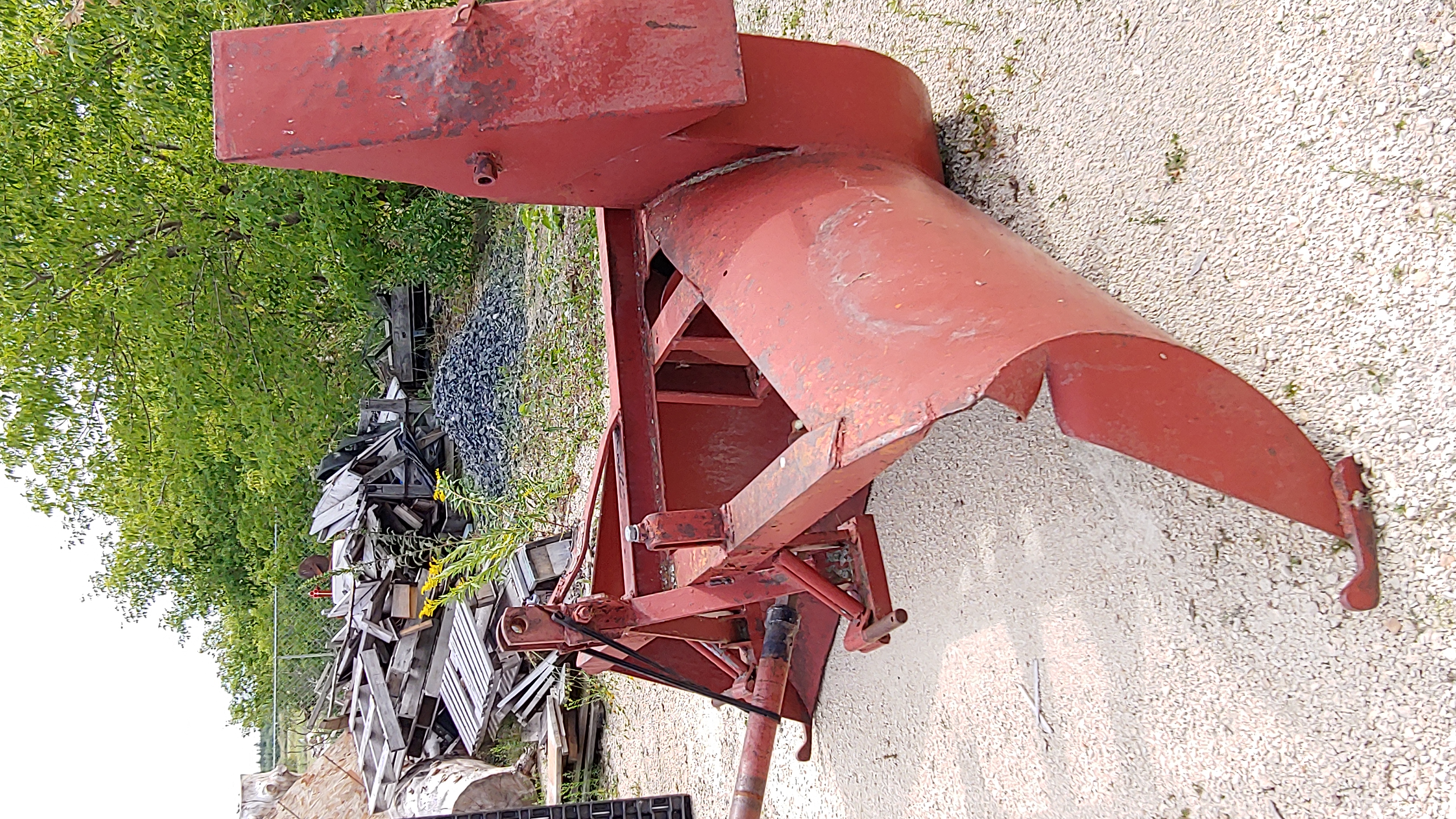

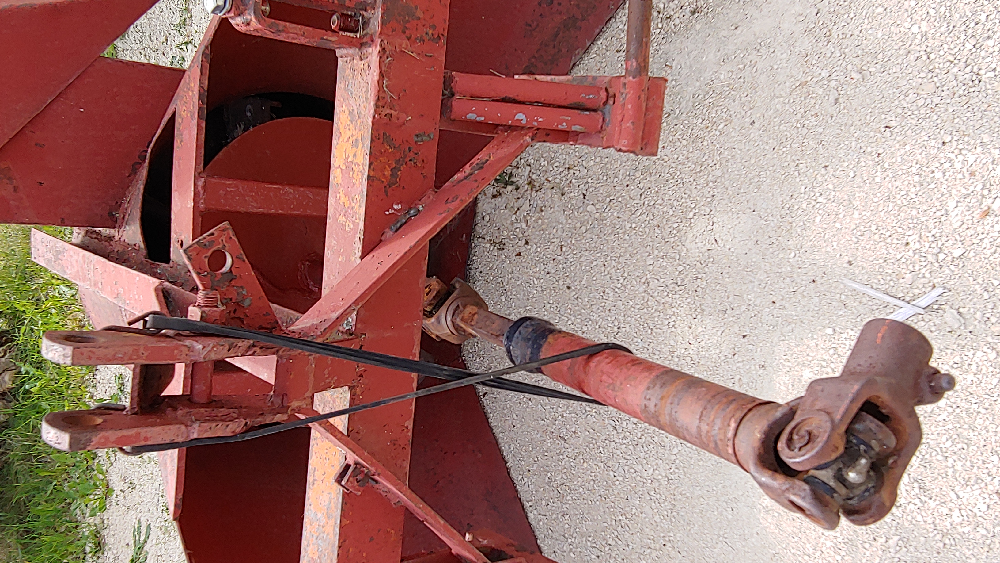

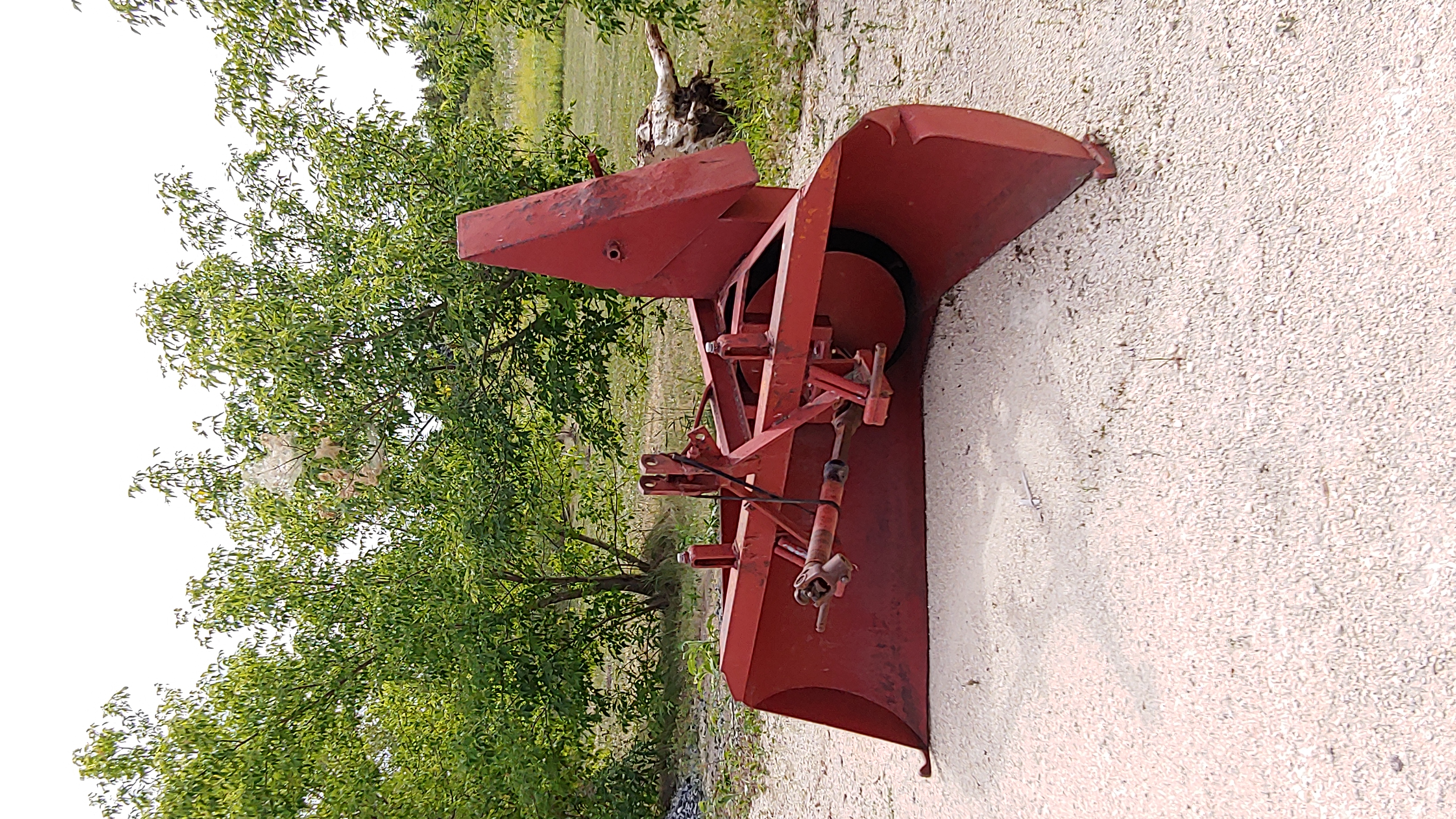

We acquired a vintage snowblower as part of package deal. It works quite smoothly. Hooked up to our tractor to test it. But it is much too large and would require too many modifications. Please let us know what you can as no company names are visible. (Looks to have been repainted at some time.)
6'6" wide 20190815_143650_HDR.jpg20190815_144251_HDR.jpg20190815_144014_HDR.jpg20190815_143946_HDR.jpg

Welcome to the forum. About your snow blower, it should have an Identifaction tag riveted to the frame of the snow blower either by the gearbox or on one of the side weldments.

How much does that weigh? Need a really big tractor for it.

It looks homemade to me but I could be wrong. It’s got flat bar, angle iron, pipe, and I beam for the hitch. No wear bar on the sides and they appear to be cut in half pipe. I’m not saying there’s anything wrong with it but it doesn’t look like a commercially produced piece.

There is a manufacturer part description plate on it but it appears to have been painted over. Thank you. I still have yo learn what wear bars are... Lol

It looks like it might have been produced by a small company that didn't have a large area of distribution. If you tell us your approximate location, it might help with the identification.
