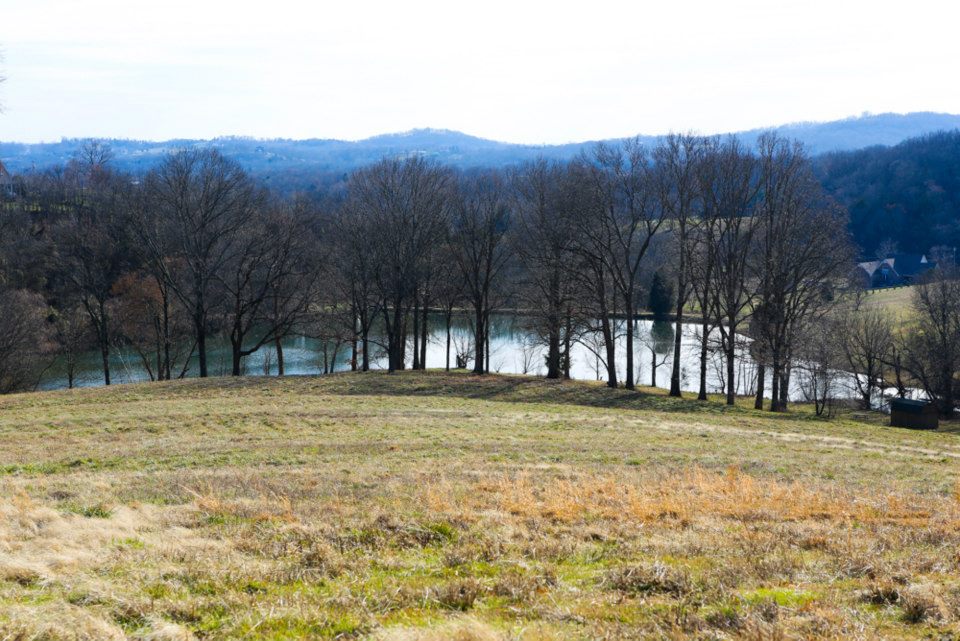

I was originally looking in to strictly finishing mowers ~ but I think my slope may be "mild" enough, that I can use a tractor with bush hog/finishing mower.
Here are some pictures. Grade is probably 15-20%. Was thinking about a cabbed JD 3000/4000 series tractor.

Here are come pictures:

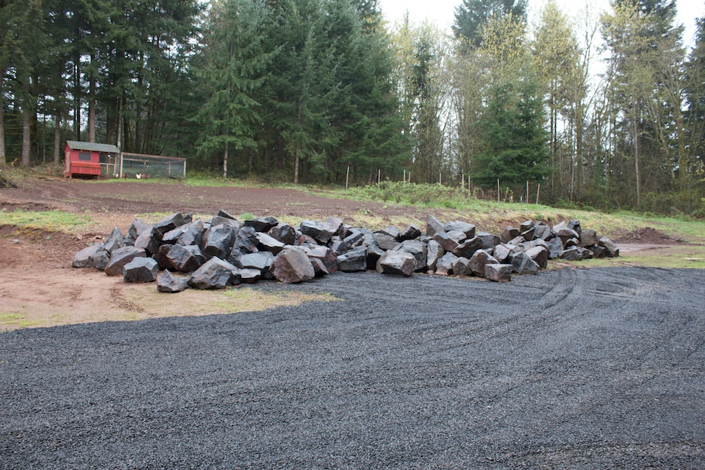

Sure, here is a pic of one part of the property. The area below the coop I till with a Deere 665 tiller on my 3520 and while I can go side to side just fine, I wouldn't want any more slope than that. The picture is probably a little misleading with the slope though, so sorry about that. I can tell you for this 5 acres it is a 30 foot drop over 600 feet. I also operate on other property that is more steep that I won't even attempt to go on with my tractor. slope.jpg

Great picture jeffster! Just what I was after, thanks for sharing! My slopes are quite a bit worse than that. I have a feeling a Ventrac is in my near future :)
