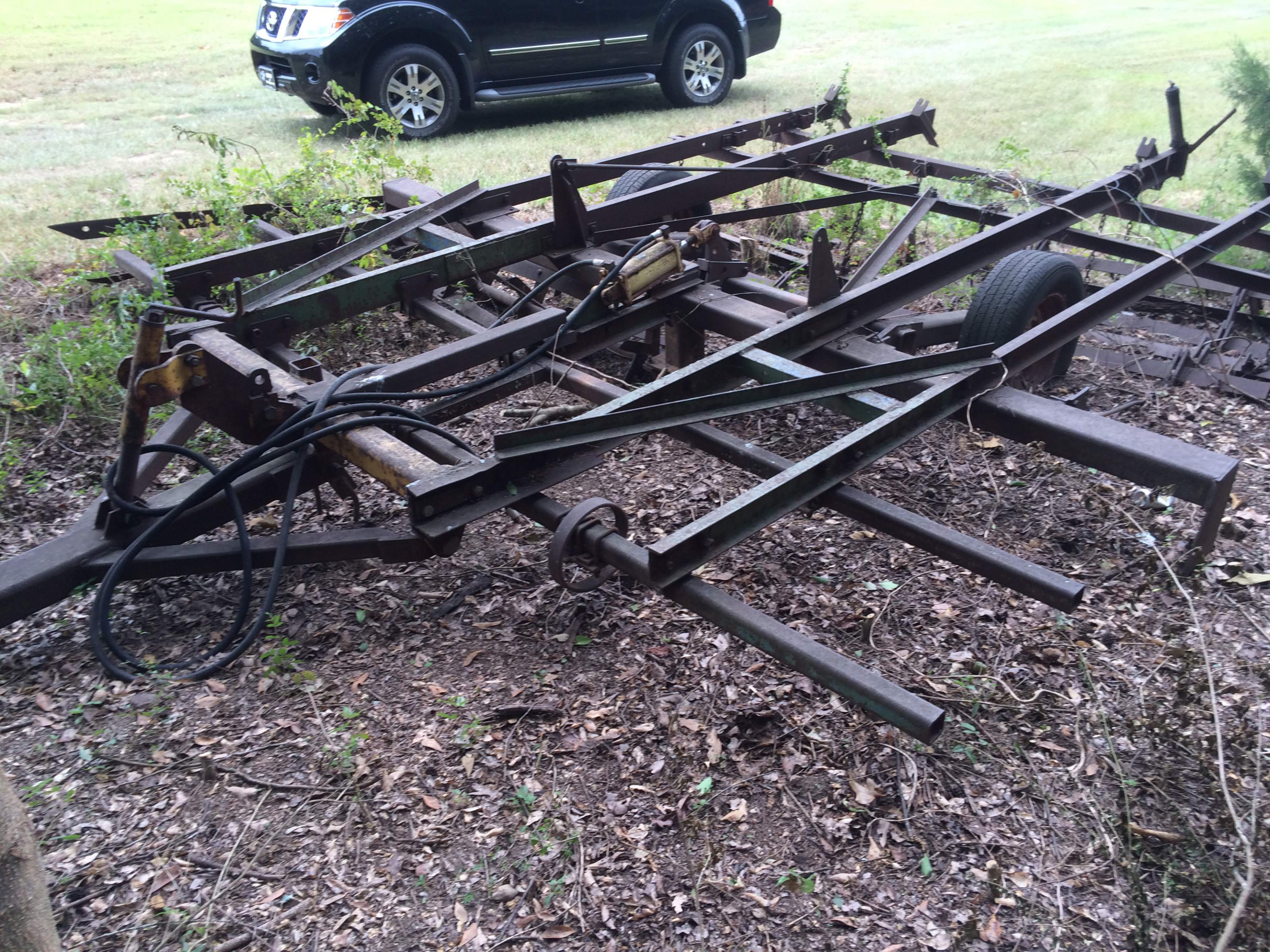

I recently bought some land and the previous owners left what I believe is an old field cultivator. They said I could do whatever I wanted with it, so I need to know it's worth anything more than scrap metal. I can't post pictures right now but I could text them. It's at least 10' wide and 10' in length. It has a long hitch arm with a ring type hitch. It has two rotary type tiller looking deals on the back and the shaft is broken on one of those. It has some kind of hydraulic lift on the front half. It's old and rusty and the tires are flat. I believe it was originally painted Yellow. Other than cutting it up for scrap, I don't know what I could do with it?

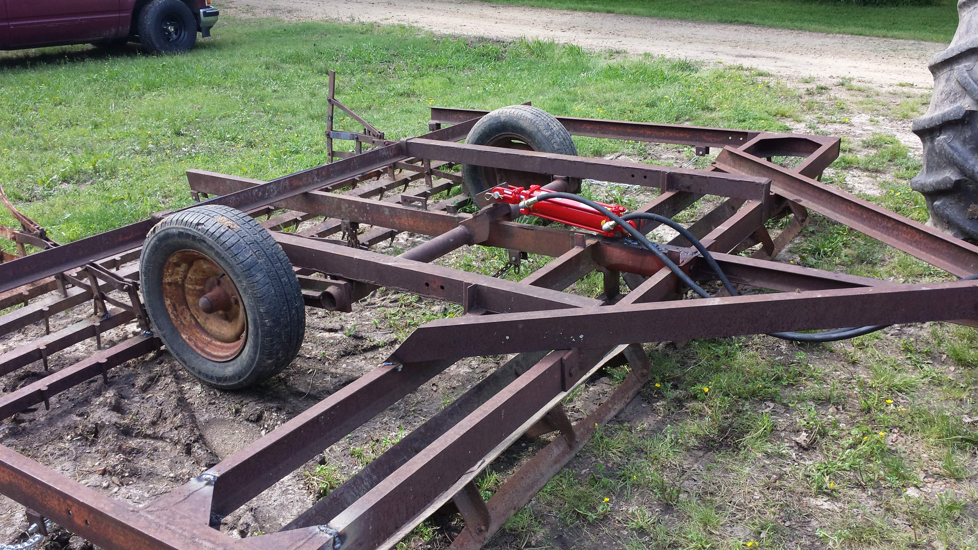

Sounds like a do-all maybe?
Back when everything was planted up on hipped up (aka bedded) rows.
After pulling up rows and before planting you pulled a do all over them and it flattened out the top of the row and broke up the clods.
It is useful to on a field that has been disked as well to break up the clods and give you a good surface to plant in.
   / What Kind of Attachment is This #3
20150426_153328.jpg Does it look anything like this?

View attachment 439645 Does it look anything like this?

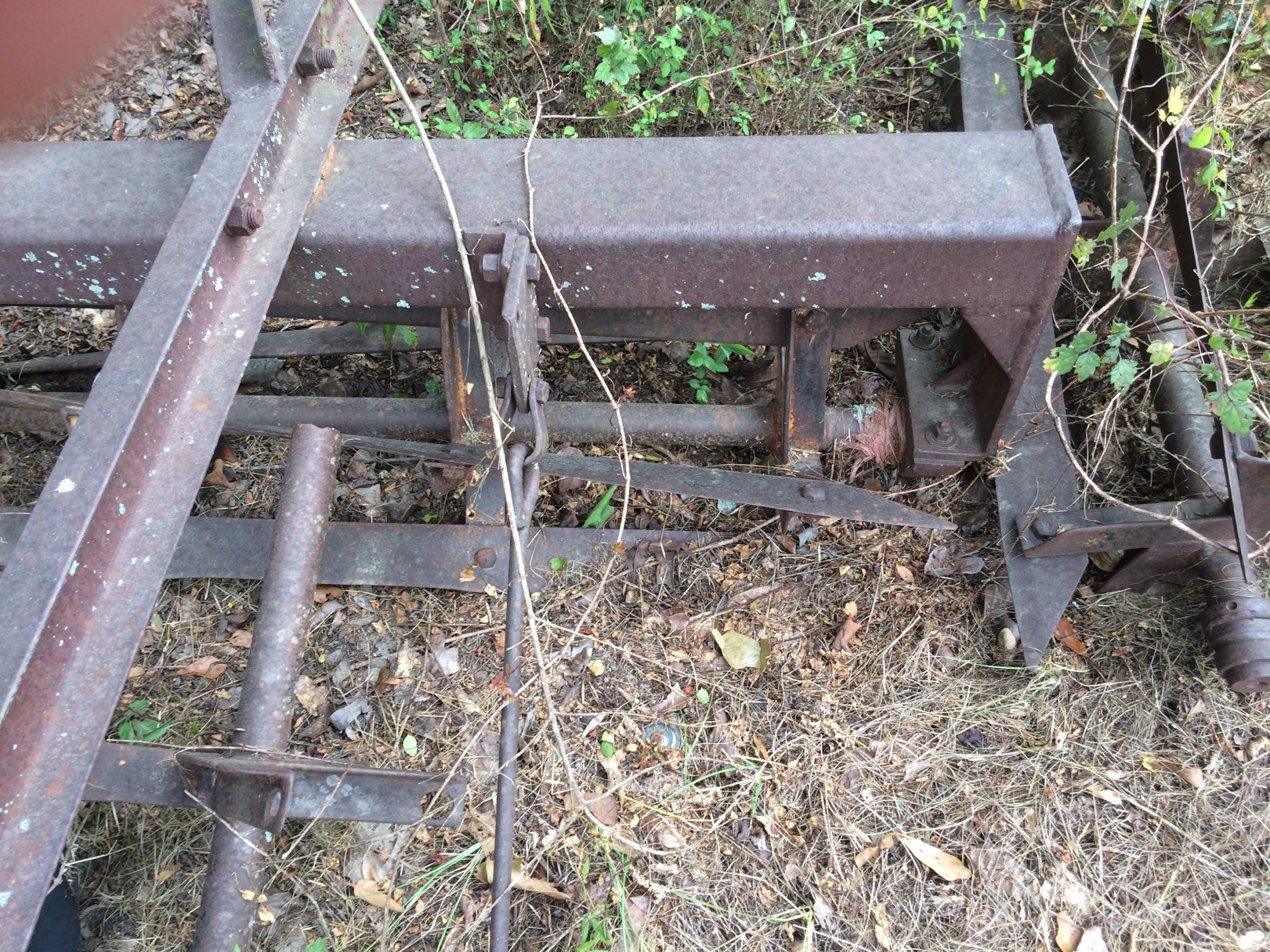

Yes, it is very similar to that. I went back out and looked at it again and it has two hydraulic pumps on it. It's a very heavy duty attachment. I hate to cut it up for scrap if anyone could use it. I'll try to post some pictures and just let someone have it if they will come get it. Thanks
   / What Kind of Attachment is This #7
old spring tooth rolling harrow used to finish a field before planting. Looks like it been robbed pretty good. Its worth more than scrap IMO lots of good steel to be used for projects.

That looks like it would be perfect base for a a grader type attachment.
