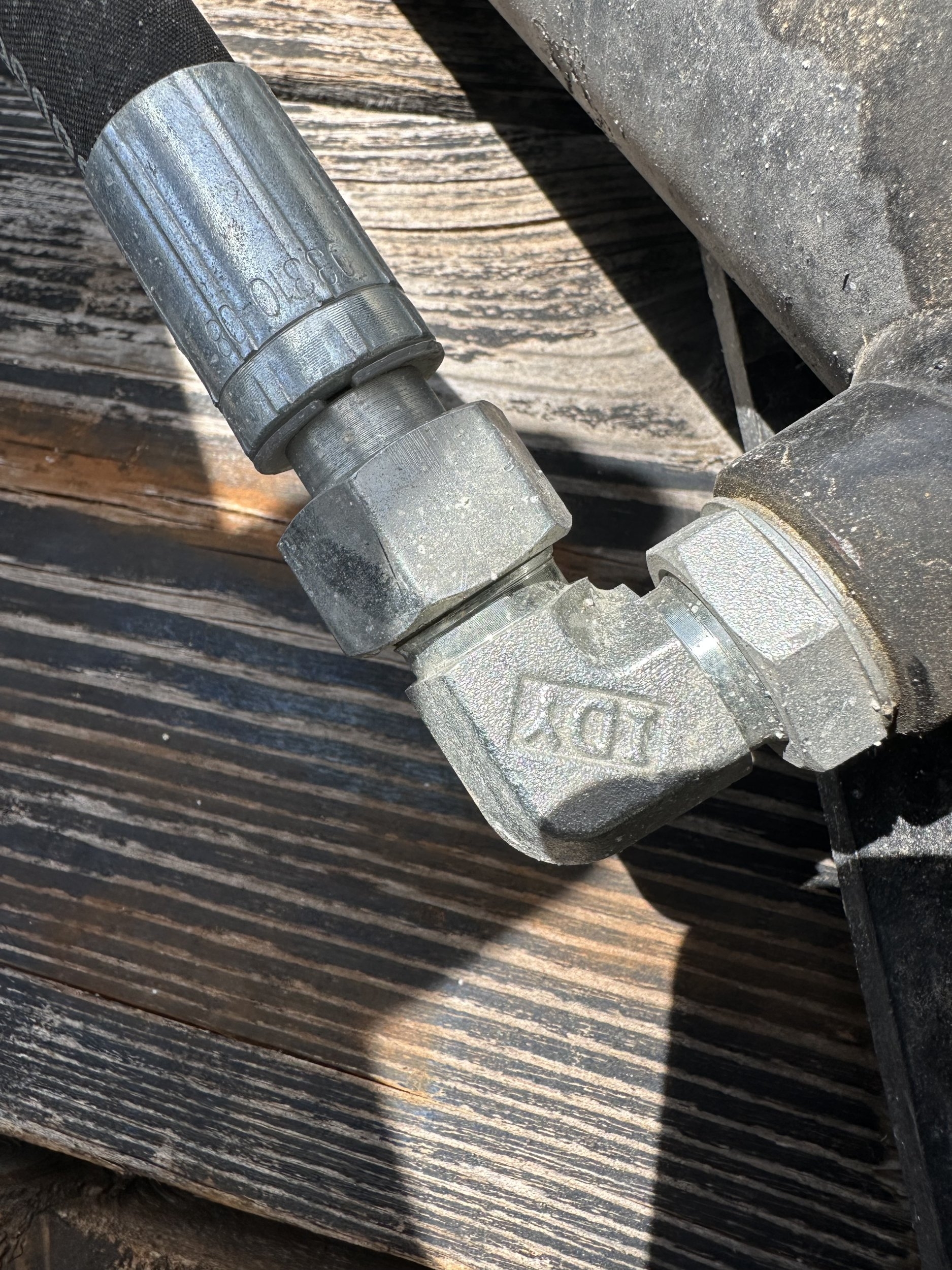

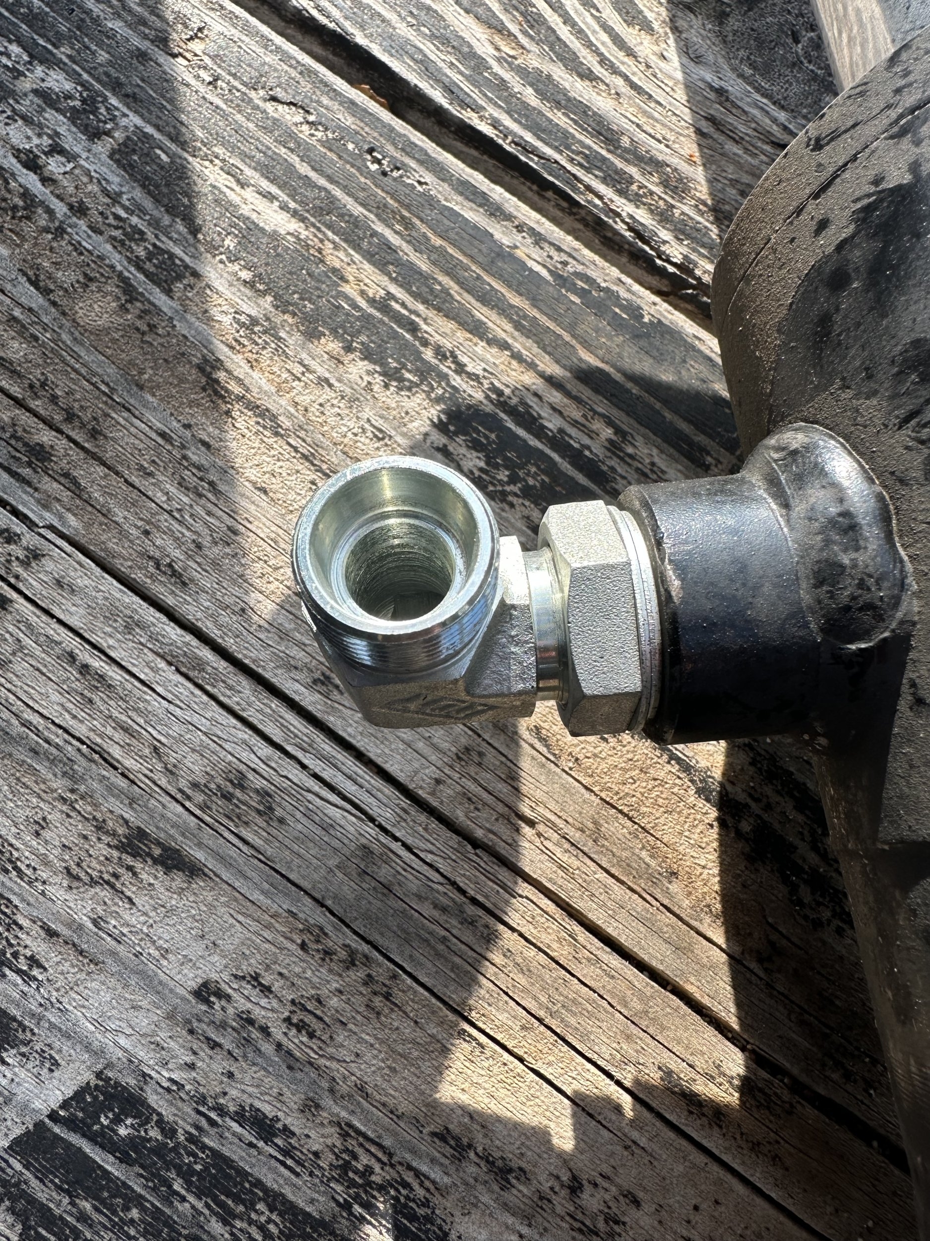

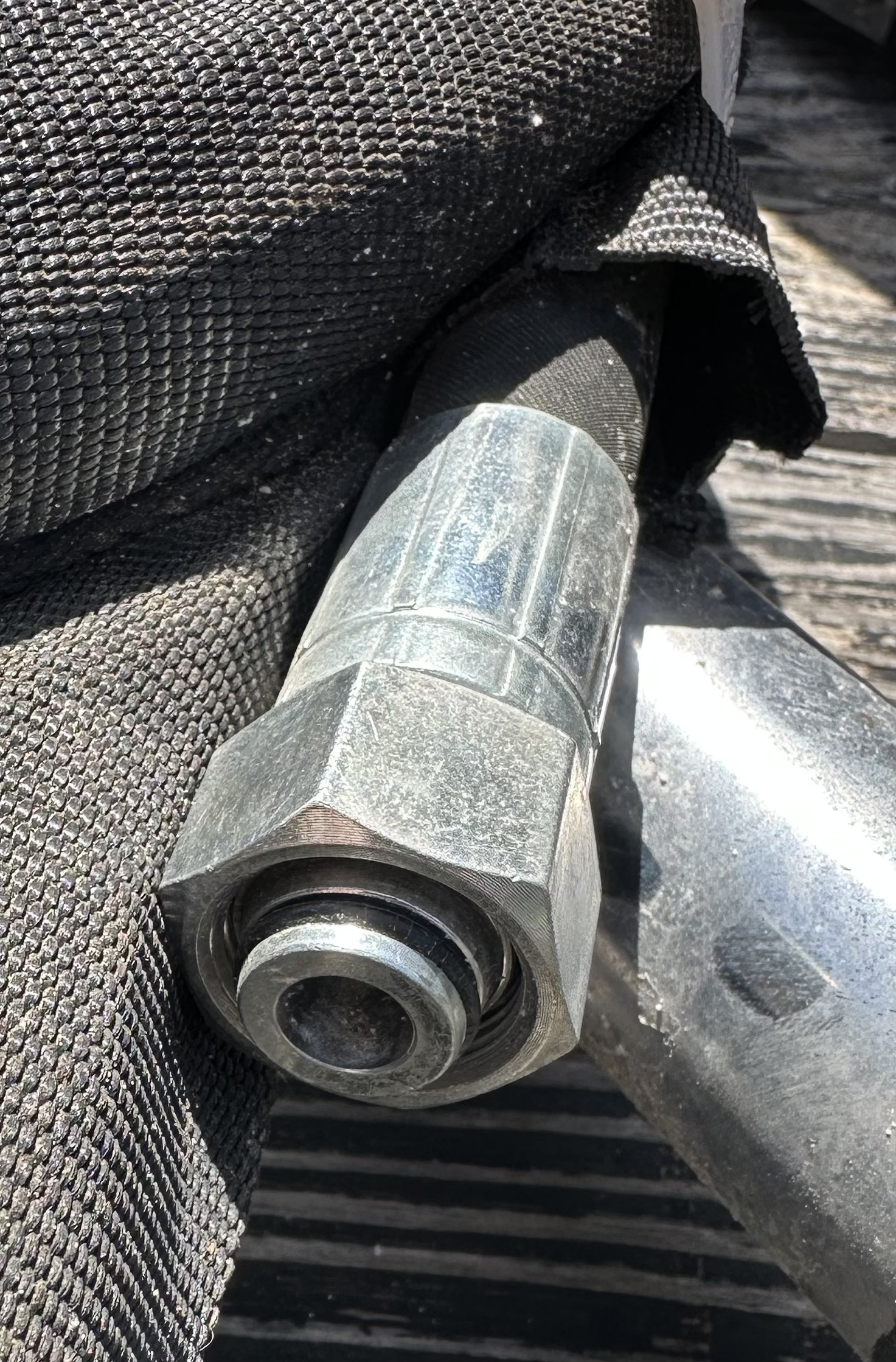

Bought a tree shear at auction, probably Chinese junk. One hose was missing a quick connect. It has this weird connector. I need to go from this (female) to 1/2” NPT male. Any idea what it is?

Sweet! Looks like a DIN 2353.
   / What kind of hydraulic fitting is this? #5
That's a pretty standard type of fitting. It's indeed a DIN 2353 fitting.
