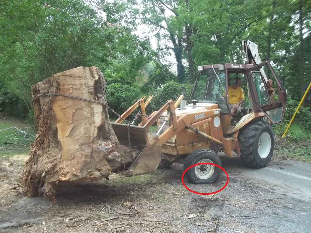

depending on where you wind up, i think easiest most sensible and economic option is to buy a used full size backhoe think Case 580 or similar. a decent used machine can easily be had within your budget. a worn out full ize backhoe will easily out dig any backhoe on a compact tractor. do what you need to do and sell it. my father bought this Case 580 8 ish year ago, for 6500 we have put about 1500 into into maintenance and repairs wise and put 300ish (could be higher) hours on it. is it perfect nope, it it too big for me to want to haul it on my trailer yep. but it does what we need it to do. this might not work for you, you may not have the tools or experience to work on a used backhoe.

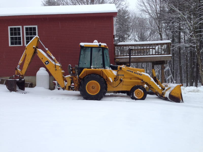

You really need to buy a parcel of land first, before being able to know what you need.
You may buy land that's all field and easy digging, or you may buy a mature forest. You'd need different equipment for each.
For the sake of discussion though, if I were you I would be looking into spending 20-30 grand on a 20k-30k pound excavator with thumb. That is the ideal machine for clearing land, putting in a driveway, digging foundations, and many other tasks.
To stay within your 15k budget I do agree that an older backhoe is the way to go.
I think my father and I paid 10-12k or so for our JD 410B in very good condition. It would do all those tasks but after owning one and also running an excavator, I'd rather an excavator for the specialty job of land clearing and home site work.
