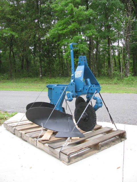

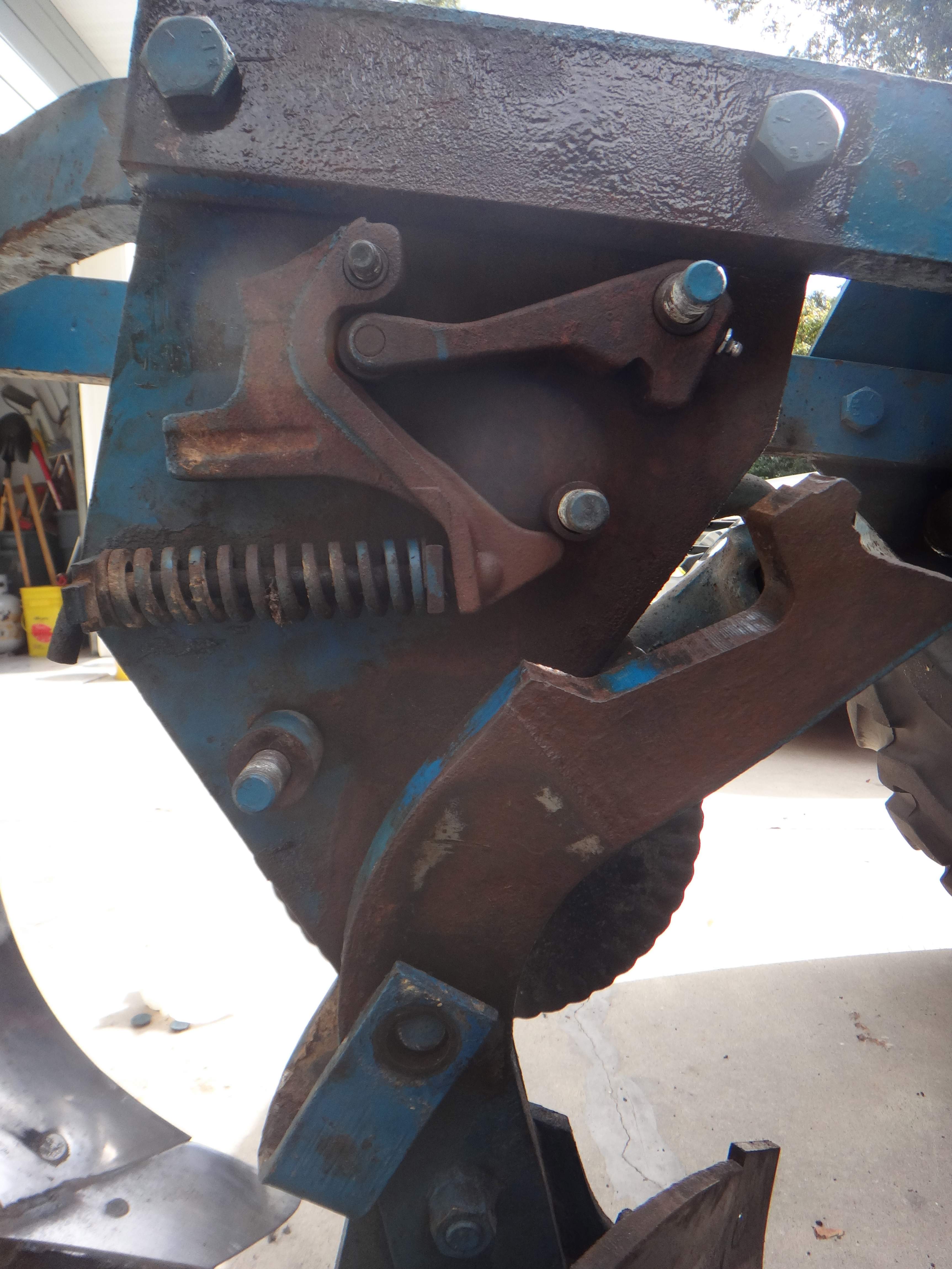

I am not a general plow expert. I have owned/operated only two plows, my Ford Series 101 plow and a 12" ETA single bottom plow. I paid $1,200 for my Ford trip plow, in excellent condition, several years ago.
The Oliver plow looks good to me. It is identified as a trip plow which is good. When my plow arrived I had to open the trip mechanism and clean all the congealed grease, rust and dust out to make it trip properly. I was coached by the Kubota mechanic. It may have had 50 years of debris accumulation. That was several years ago. It has tripped fine since.
Good to see it has two coulters. Coulters are mostly necessary for breaking sod.
With plows the question is are the moldboards aligned with the frame precisely? If not, the plow will turn dirt but not necessarily yield those SO SATISFYING perfect furrows.
It is a 14" plow, so it will potentially turn dirt perfectly from 6" to 8" deep. A plow takes longer to learn to adjust for good results than any other 3-Pt. implement.
