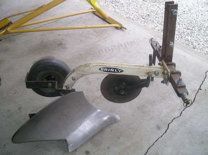

I used a 12 inch Brinly Plow for a few years. It worked great. Your JD dealer sells re-branded Brinly plows painted green but they run about $500. Watch Craigs List for a used Brinly selling for around $200 or less. I have seen them for as little as $75.
