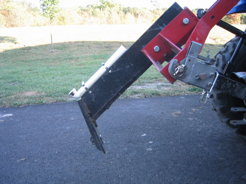

I am planning to lay wiring for landscape lighting, and eventually an invisible dog fence. I need something that will dig a trench a few inches deep, and a few inches wide (in other words, nothing as big as what a backhoe would dig). I am new to the whole tractor thing, but wonder if there is something that I could get that would allow me to just drag it behind the tractor and go. What do you think? Any thoughts would be really helpful.

   / What kind of tool to lay landscape light wiring? #3
Better than a regular sub-soiler you need a fancy one to do the job right!
Go to the hardware store and buy a small piece of plastic pipe with a right angle bend, 2 large hose clamps and a new drill bit (about 5/8"). Drill 2 holes in the trailing edge of the subsoiler, one near the bottom, one about 10" up from the other hole.
String your 2 hose clamps through the newly drilled holes, and use them to clamp the pipe to the trailing edge of the subsoiler.
Now mount the subsoiler to your tractor, run some wire down through the pipe on the back and stake it off at the beginning of your wire run. Drive forward with subsoiler down and it will automatically bury your cable while digging the trench. Be sure to slowly feed the wire while you drive.

   / What kind of tool to lay landscape light wiring? #4
Or you can buy a box blade with scarifiers. Drop one scarifier modified as Bob suggested, though the trench will be narrower than using a subsoiler.

   / What kind of tool to lay landscape light wiring? #6
RonR . . . I've not tried to bury wire by using a scarifier on the box blade, but the wire would be buried at a much shallower depth. The subsoiler puts the wire down much deeper than a scarifier. Sometimes that makes a difference, sometimes not. I suppose it depends on your needs. Both should work.
   / What kind of tool to lay landscape light wiring? #7
How deep must the line be to meet regulations where you live? This may depict the type of tool required.

   / What kind of tool to lay landscape light wiring? #10
Low Voltage lighting does not have a spec. It's only 12v. In most area's, normal house voltages(120/240V) has to be a minimum of 18" deep.
