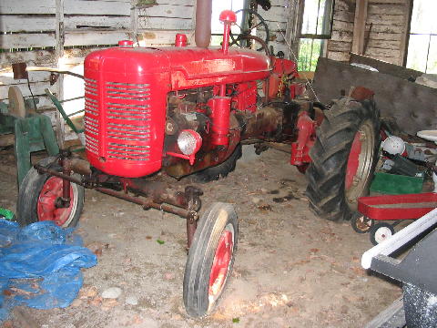

I finally had the time to git the #'s for all of u guys that really care!!!!!! and so here they r!!!!!
ON THE TRANSMISSION BETWEEN THE SEAT AND THE GAS TANK LEFT HAND SID SITTIN ON THE SEAT!!!!!!!...8638DE.....
ON THE OPPOSITE SIDE ...JIST ABOVE THE OIL PAN!!!..ON THE BLOCK!!!......." 11210" AND THAT AFTER A SEARCH OF ABOUT 45 MINS IS ALL I COULD COME UP WITH????
So what do u guys think>>>!!!!!! I am sincerly sorry bout all the nay sayin!! CUZ I WILL ALWAYS COME THRU IN A BIND!!!!!!!! ....................ALWAY'S!!!!!! /forums/images/graemlins/cool.gif /forums/images/graemlins/cool.gif /forums/images/graemlins/cool.gif
PERIOD .......PARAGRAPH........END!!!!!!! /forums/images/graemlins/mad.gif /forums/images/graemlins/mad.gif
PLEASE DON'T EVER FORGET THAT MY FRIEND'S /forums/images/graemlins/blush.gif /forums/images/graemlins/blush.gif /forums/images/graemlins/grin.gif
/forums/images/graemlins/grin.gif /forums/images/graemlins/grin.gif /forums/images/graemlins/grin.gif /forums/images/graemlins/grin.gif /forums/images/graemlins/grin.gif /forums/images/graemlins/grin.gif /forums/images/graemlins/grin.gif /forums/images/graemlins/grin.gif /forums/images/graemlins/grin.gif /forums/images/graemlins/grin.gif
IF I SAY I'LL B THERE ....I'LL B THERE !!IF I SAY THAT SUMFIN WILL B THERE ...IT MOST DEFINITELY WILL!!!!!! /forums/images/graemlins/wink.gif /forums/images/graemlins/wink.gif
I TO!!!!! AHVE A LIFE AND ABOVE AND BEYOND THAT I CANNOT CONTROL LIFE'S IDEOSYNCRACIES!!!! /forums/images/graemlins/cool.gif /forums/images/graemlins/cool.gif
LOVE YA'LL /forums/images/graemlins/cool.gif /forums/images/graemlins/cool.gif /forums/images/graemlins/cool.gif /forums/images/graemlins/wink.gif /forums/images/graemlins/wink.gif /forums/images/graemlins/grin.gif /forums/images/graemlins/grin.gif /forums/images/graemlins/grin.gif /forums/images/graemlins/wink.gif /forums/images/graemlins/wink.gif
TODD HALL from liddl ol' maine /forums/images/graemlins/laugh.gif /forums/images/graemlins/laugh.gif
   / What kind of tractor is this????
#28
i am ONLY ONE MAN!!! AND YES U SILL git yer eye splice..amongst all of the other things that i would like to share with ya'll!!!..rigging....101.....fencing ....101 ...soon to culminate!!!..ckens..boxes and coyote proof portable houses !!....101...everything i do i would live to share with u guys but have only one set of hands!!!!....Love all of ya'll to death!!!...and will !!!!!!!!ALWAY'S HAVE PICS!!!!!!! AS A GOOD EXAMPLE TO ALL OF THE NEW COMER'S!!!! /forums/images/graemlins/grin.gif /forums/images/graemlins/grin.gif /forums/images/graemlins/grin.gif
   / What kind of tractor is this???? #29
Okie Dokie now /forums/images/graemlins/cool.gif
The engine code is useful /forums/images/graemlins/grin.gif That code coorelates to a casting date of November 21, 1945. Based on that, this tractor was a very late '45, or an early '46. The "0" at the end indicates year, 0 being '45. Mine has a "J", indicating '40. They are, for your reading enjoyment:
H 1938
I 1939
J 1940
K 1941
L 1942
M 1943
N 1944
O 1945
P 1946
Q 1947
The letters continue up to 1958.
The other number is a part number or something. Mine has similar numbers on the shifter tower, and on the torque tube(8638DA)
Now, it is not a sure thing without a serial number. Engines wore out, got changed ect, so it may have a different year drivetrain.
My tranny has a cast code, on the side next to where your left shin would be. It is 124J, indicating a Dec 4, 1940 casting date.
In my case, the numbers make sense, as the serial number is for a '41, and the cast codesfor tranny and engine are late '40,, which makes sense for a '41 production tractor.
I will try to take some pictures of mine, including serial number placement. Then we can get some more numbers to coorelate better /forums/images/graemlins/grin.gif
