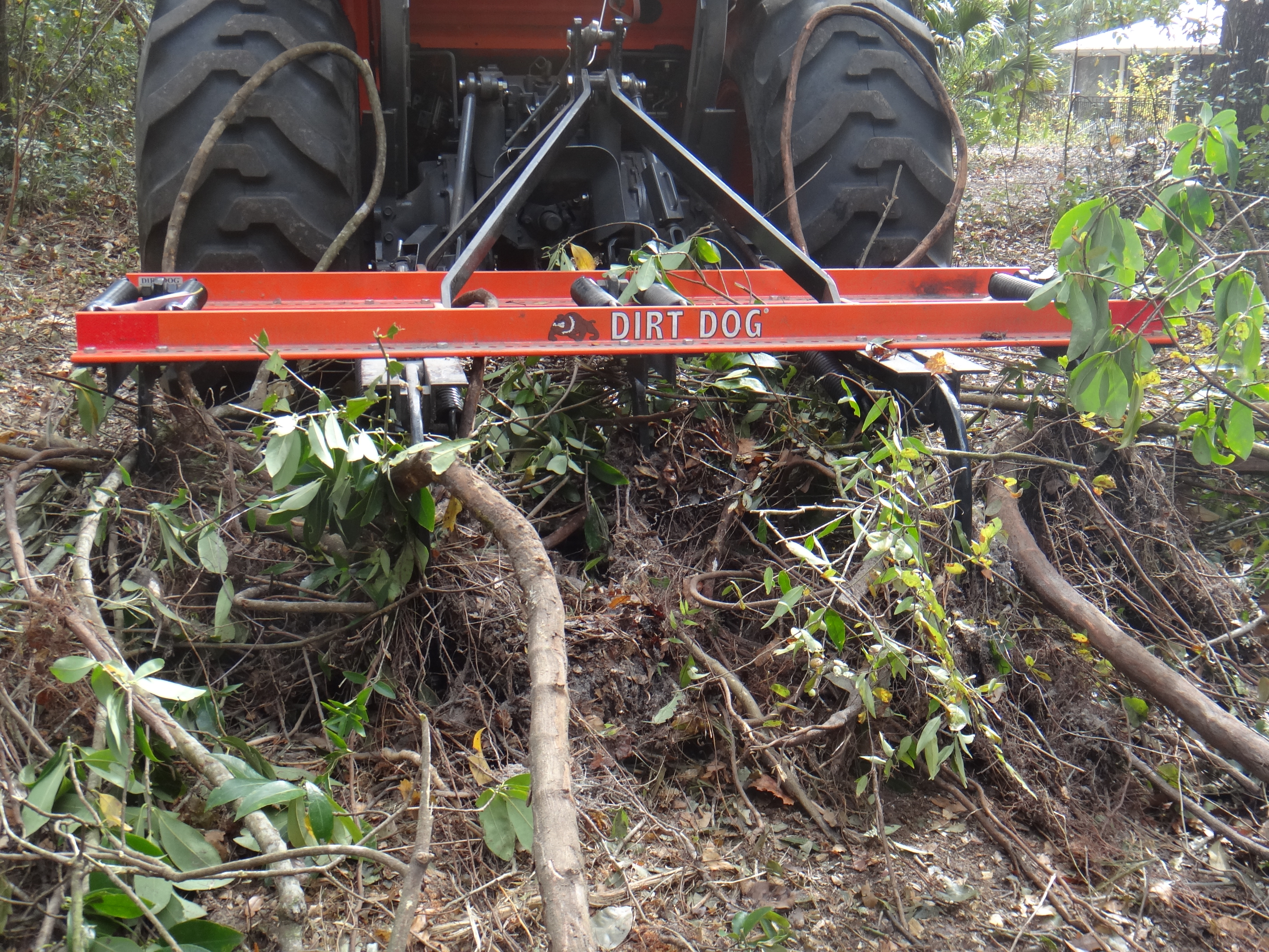

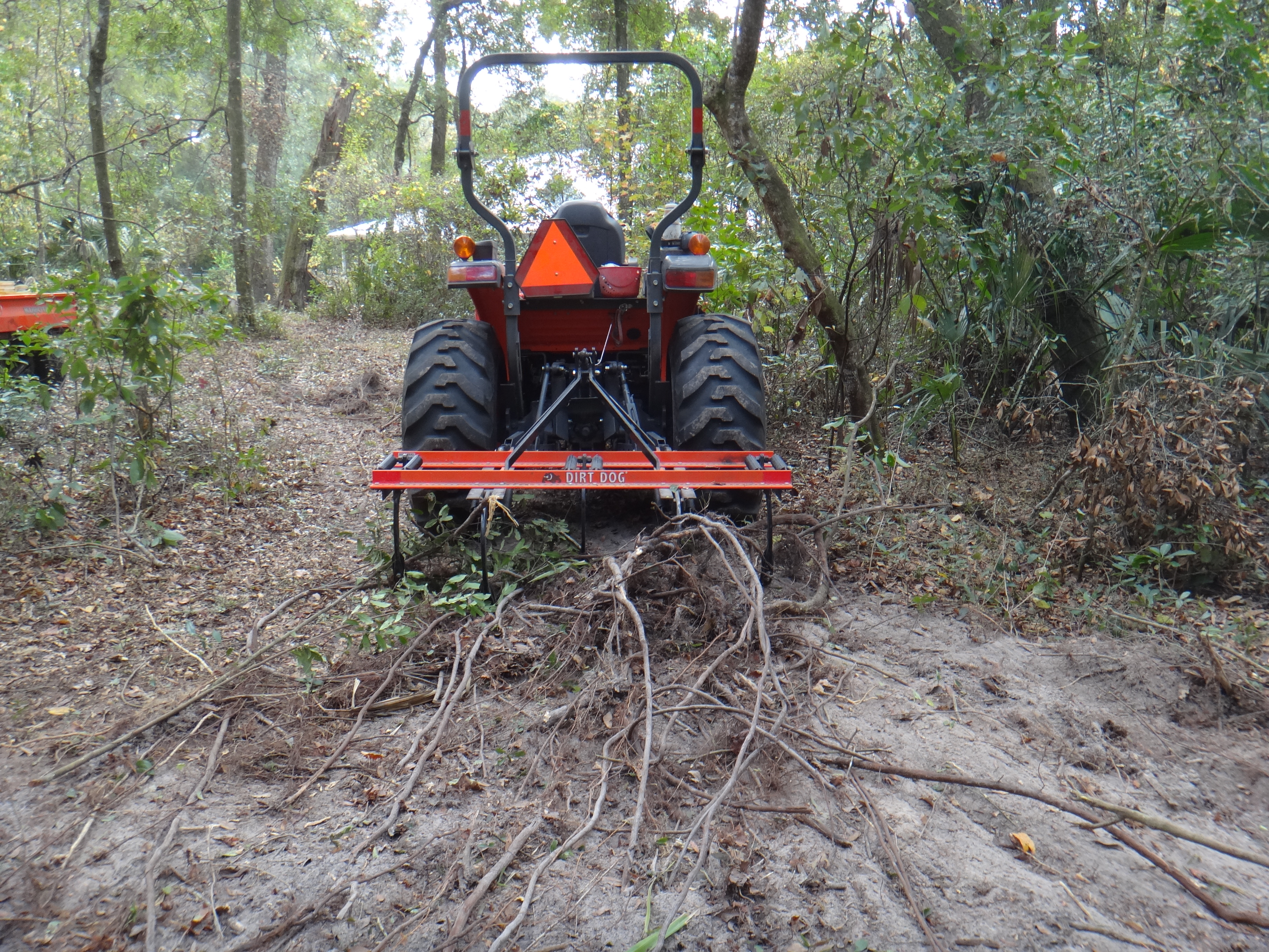

An excavator will take out the trees with root balls but leave big holes. You can stipulate in contract that holes are to be filled but contractor will likely want to trailer in a second machine, most likely a Bulldozer or a tracked, heavy Skid Steer.
A Bulldozer will take out trees the way you desire and you can stipulate in the contract holes are to be filled.
A spring-protected Field Cultivator is a good tractor implement to rake out smaller debris after tress are pulled and holes filled. Dirt Dog makes Field Cultivators with three shanks to fifteen shanks for light tractors with Cat 1 Three Point Hitch to heavier tractors with Cat 2 Three Point Hitch.
LINK: http://www.tractorbynet.com/forums/a...tml?highlight=

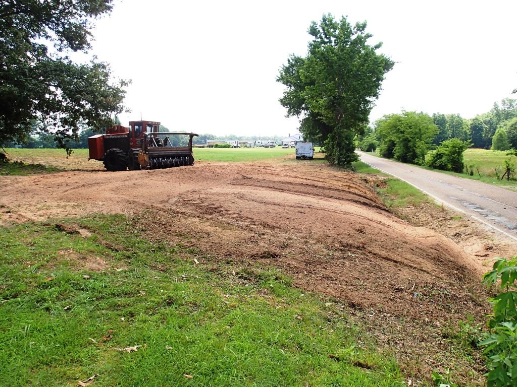

Hire someone like me that mulches for a living. If it is a big machine, it can handle anything and keep the cost per acre reasonable. Small machines won't handle big or dense forest, efficiently. Log off everything that makes you money, then call in a machine that can clean up the mess.
This red oak was 5'4" at the cut. I already ate through most of the crown prior to taking the pic. It was too big to handle or do anything with, so I ate it.
Impressive! That should handle about anything. Sadly, I have too many rocks.
