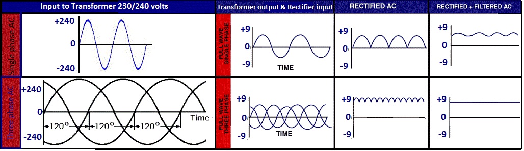

Not all DC current is created the same. Lincoln generators produce true DC current. Miller uses a rectifier to change AC into DC. Open circuit voltage and the slope (volt/amp curve) make a difference as well. Sometimes certain machines just work better with certain rods.
   / what makes a good "arc?" #6
As far as DC, until a person uses a pure DC generator like an SA-200 or similar, I don't think the difference is as clear.
A three phase rectified DC signal is about as close as a person would get.
Standard single phase rectified is the bottom.
But, my 900 lb Airco has a very smooth DC arc that does not stick, is not harsh or spattery, and runs 7018 better than any plug in welder I've used. I can push on the electrode if I want and the arc does not snuff out and stick.
My inverter machine, Invertec v250-s, is almost identical.
My little AC/DC homeowner machine does not fare as well, the arc is kind of noisy and feels different, almost like it has a pulse.
The SA-200 has a pure DC signal that feels like it just melts a rod like spreading butter.
Check out this pic of single phase (top) and three phase (bottom).
   / what makes a good "arc?" #7
