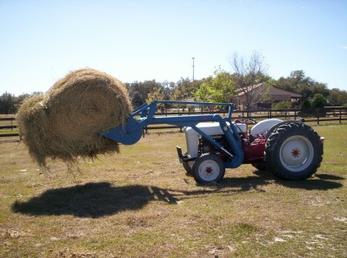

Here's a pic of my 850 moving a round bale of hay on a 1-arm ford loader.
