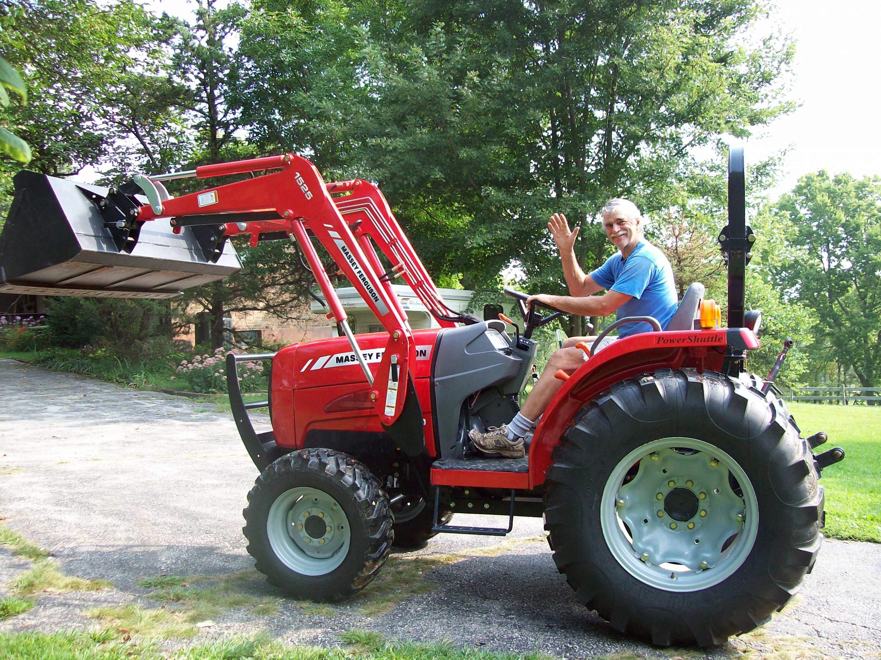

I just replaced my Ford Jubilee with a Massey Ferguson 1540 with FEL. Boy, no comparison, should have done that long ago. I had the Ford for 30 years also. Its been good tome,but that FEL and the added power is sure sweet.
I had some plowing to do this fall,and it just ate it up. I was looking at tractors for awhile and never thought I would pay that much for a tractor, but we came across a 3 year old MF that only had 100 hours and the price was right, so its ours now. And it even has parking brakes that work...yipee
