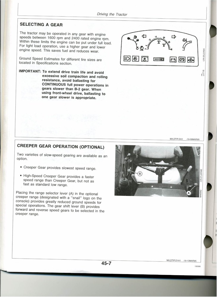

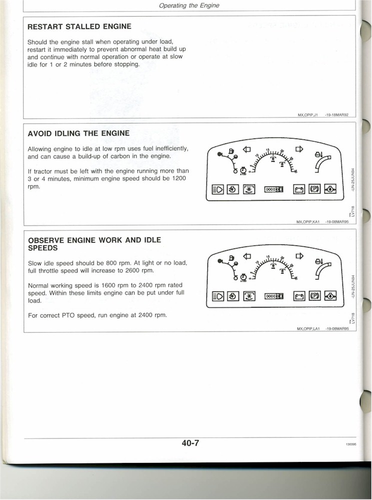

Hi,
I recently bought a 1995 JD 5400. I'm in the midst of figuring out everything I need to know about this tractor. I ordered the manual from JD 3 weeks ago and have yet to receive anything!!! Is all their service of this quality? :confused:
Anyhow, quick question for the group. What RPM should I run the engine when operating the backhoe, PTO, etc...
What RPM should I run when driving the thing on the road for a few miles? Does this hurt the tractor? I drive to/from a friends house about 5 miles away. Takes me about 30 minutes. Does this constant speed hurt it in any way?
If this makes any difference, it's a 60 something HP engine, 3 cylinder Turbo.
To date, I've been running about 2500 rpm when I need the power on the backhoe. When driving, I've been running between 2000 and 2500. Mostly 2200... Then I get impatient for a few minutes and creep up to 2500... Then I Worry about the engine and go down to 2000, then up to 2200..etc... :confused2:
Thanks!
Martin.

Couple pages from the 5400 manual regarding engine speed.

   / What RPM to run on my JD?
Thanks for the info! :thumbsup:
Have a great weekend.
Martin.
