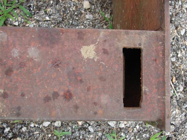

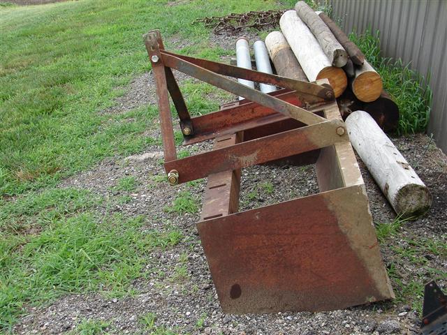

I got this blade out of the local scrap yard for $55.00. Right place, right time. I have to modified the top link so it will fit on the I Match but what is new..
For the been there and done that people. What length of shank??? I know it will have to be a notched.
The beam is 4" wide and 4-1/2" tall and 20" to the ground near level.

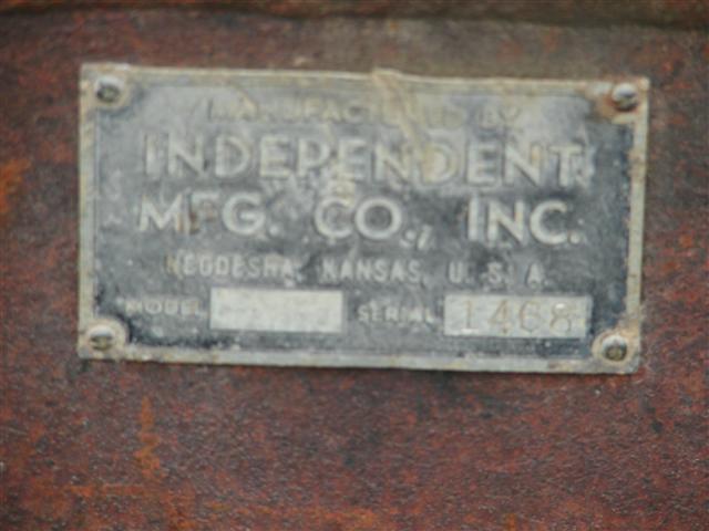

The manufacturer is Independence MFG Company made in Neodasha, Ks. serial 1468.
Check out the shank holes were cut with a torch back in the day.
Thanks for any help..

We sold that brand (IMCO)when they were in business about 15-20 years ago. I have new shanks at $21.50 each + shipping. 16 inches long X 2 1/2 wide and with 3 notches. Ken Sweet
