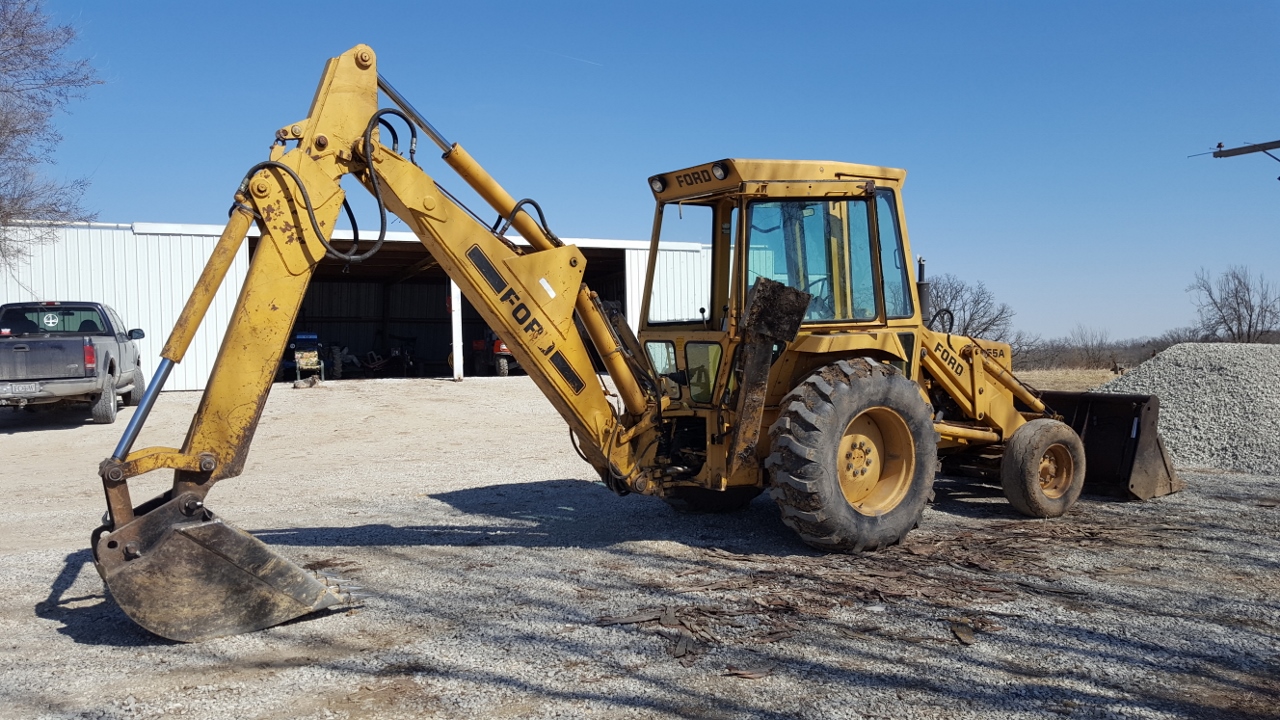

I bought a hoe last Fall. Gave $6500. Did $2000 in repairs. Now have a $8500 very dependable machine. Has a "reach" of 19ft. An excavator big enough to compete would cost 3 or 4 times what I spent.
My neighbor had a Woods 3pt hoe on a JD4240. I used it quite a few times. Handy. Patience required.
I considered buying it. Didn't want to put that stress on my tractor's 3pt. So added another machine.
