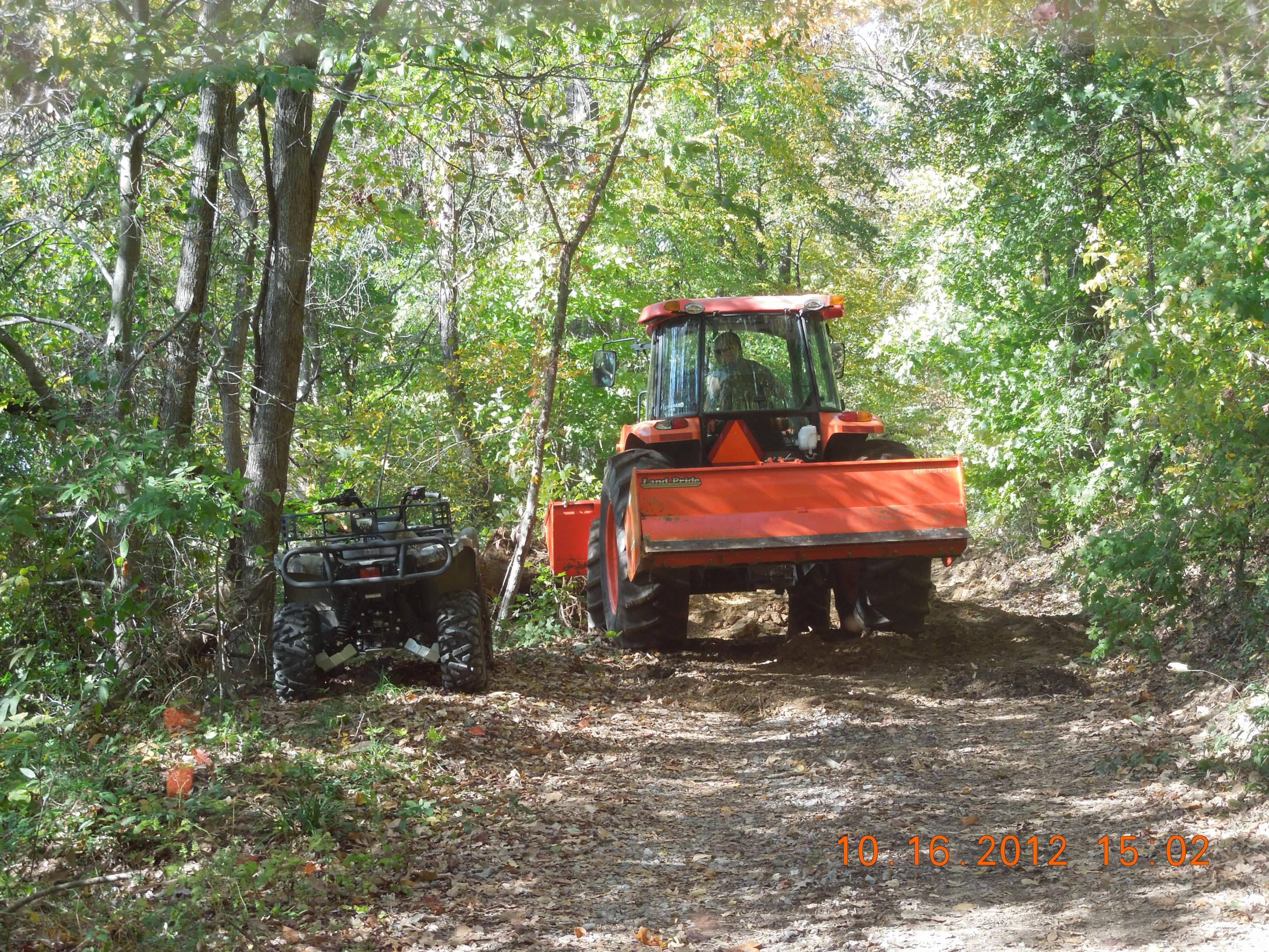

My tractor is 90". My BB is 84". For what I do with it, I get along fine. I thought I wanted an 8' but found my 7' used first. I work in the timber a lot. I think I'd be banging an 8' off trees a lot. If your work is open areas and if your primary goal is finish work, I'd suggest the 8'. For my rough work the 7' works.
   / What size box blade for my tractor? #4

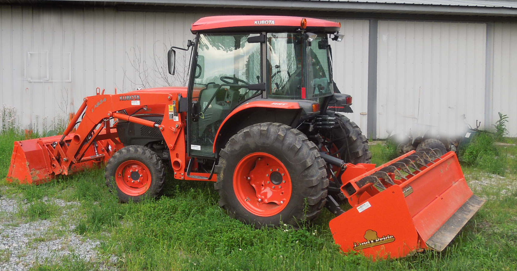

Pretty much what Richard said, we have essentially the same setups. I also use the 84" on my L5740 and have snagged a tree or two, I just have to watch where I'm going.
