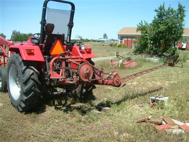

Sicklebar mower with 6 or 7 ft cutter. Mine is an old Massey Ferguson 31 that I rebuilt (several times). Paid $550 at auction and put about $250 in new parts to get it going.
