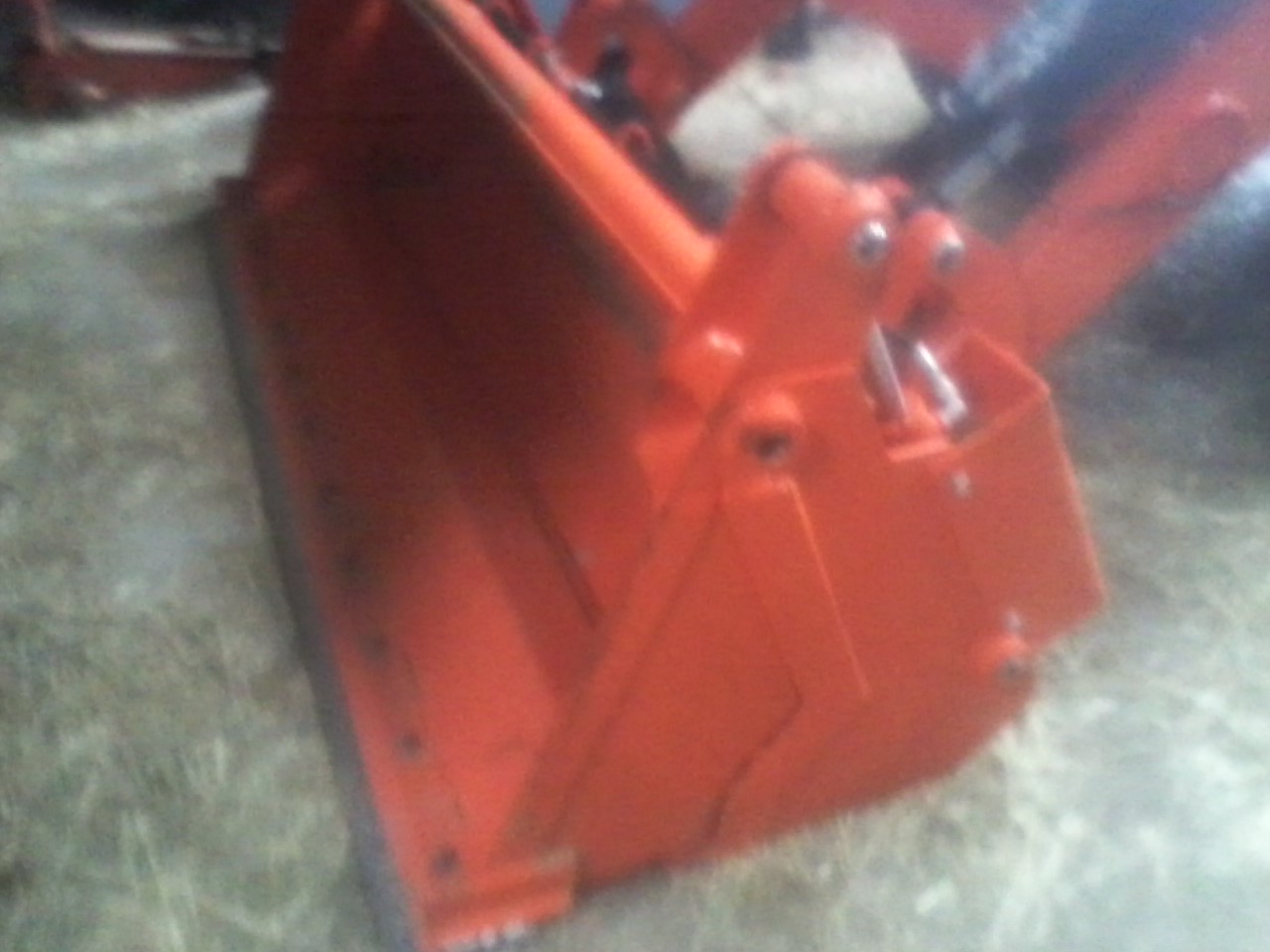

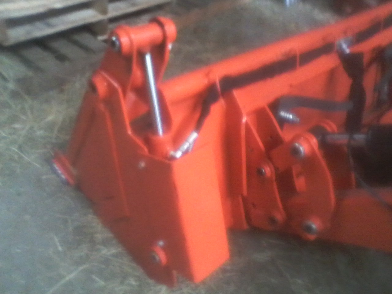

I like it only 50 hours so far , No grapple I have the 4-1 bucket I use my l3800 more in the winter because I have the Agrex Tractor PTO Fertilizer Spreader with sand in it for the winter
   / what size grapple #9
