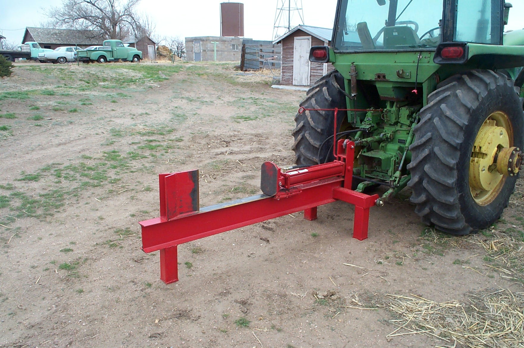

not that it means any thing but here is a first picture of mine, it has evolved from this over the years,
