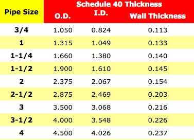

I see a lot of you have added a steel pipe to your rear blade. I have an 8’ wide blade at 950lbs using it on a gravel drive.
Is there a rule of thumb for diameter of the pipe?
It doesn’t seem like it would matter too much, but curious what has worked well for you guys that have done it.

At some point if the diameter is too small it will dig into the gravel and you won't get the intended benefit. If the diameter is too big it won't scrape too well. I used a 1" galvanized water pipe (1-1/4" OD) and it works OK on my crusher-run gravel. Would not want to go smaller than that. I experimented with PVC pipe for a couple winters first (worked fine but wore out quickly) which is how I settled on that size.

I don't have a back blade but I did make an edge protector for my bucket. I used 1/2" schedule 40 black pipe. The main reason I choose 1/2" is due to the cutting edge of my blade being 7/16" thick so I figured the pipe would tend to roll and move less if the id were close to the blade thickness. I suspect a blade is going to abuse the edge protector a bit more than I would get on my bucket so my suggestion would be to use 1/2" schedule 80 pipe. I would have used schedule 80 on my bucket if I could have found any around here.

1/2” is much too small based on my testing. The standard cutting edge on a rear blade has about 1/4” diameter equivalent edge. For snow removal on gravel you want to have a smooth rounded surface with some added surface area that doesn’t let the edge dig in (the edge of a rear blade is perpendicular to the ground with some weight pushing it down). 1/2” isn’t much of an improvement. I didn’t start to see good results until I got to an inch or more.

BTW, all of this is dependent on your surface. What works on my crusher-run driveway and exposed aggregate concrete garage apron is 1-1.25", but that doesn't mean anything on different surfaces you folks might have, so take my above comments with a grain of salt. I bet you'd need to go larger than 1" pipe on large gravel (such as #3). Conversely, 1/2" is probably file on asphalt. Whether or not the surface freezes is another factor.

Keep in mind, 1/2" schedule 40 pipe is approximately 7/8" O.D., schedule 80 will be just over one inch O.D. Pipe size is determined by the I.D.

This is not right. Pipe size = OD (2" is 2" OD etc ) and doesn't change on the OD till it reaches 14" when from then on up it is measured in I.D. just like tubing.
Tubing size is measured in ID size therefore a 2" tubing will be 2" inside measurement and depending on the thickness it will be larger OD progressively as the wall thickness gets thicker.
