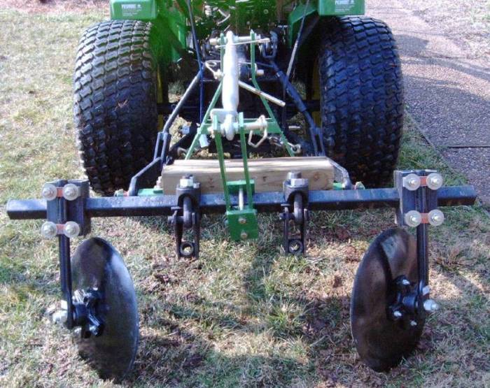

Attached is a picture of my 20" disc hillers I used to make raised rows with my 4010.
Think it would pull these paired up in parallel mode in sandy loam soil. My only doubt about doing it would be the attachments for the disc hiller shanks. They might eventually come loose; however, they didn't while doing 20 rows in my garden.
Ralph
