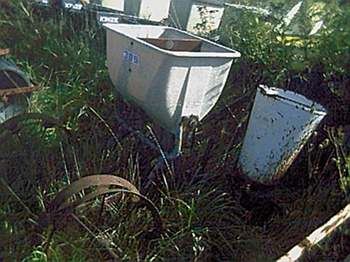

Thanks for the info. I did locate an old Ford 2 row seeder, but it appeared to need a lot of work. see attachment.
   / What size seeder can I pull? #4
I agree with stmiller2. Planters pull relatively easy. L3010 should have not problems. If you find a 3pt planter, be sure it is not to heavy for the lift arms. Try to find one in working condition. Parts may be hard to find and possibly could cost more than the planter.
