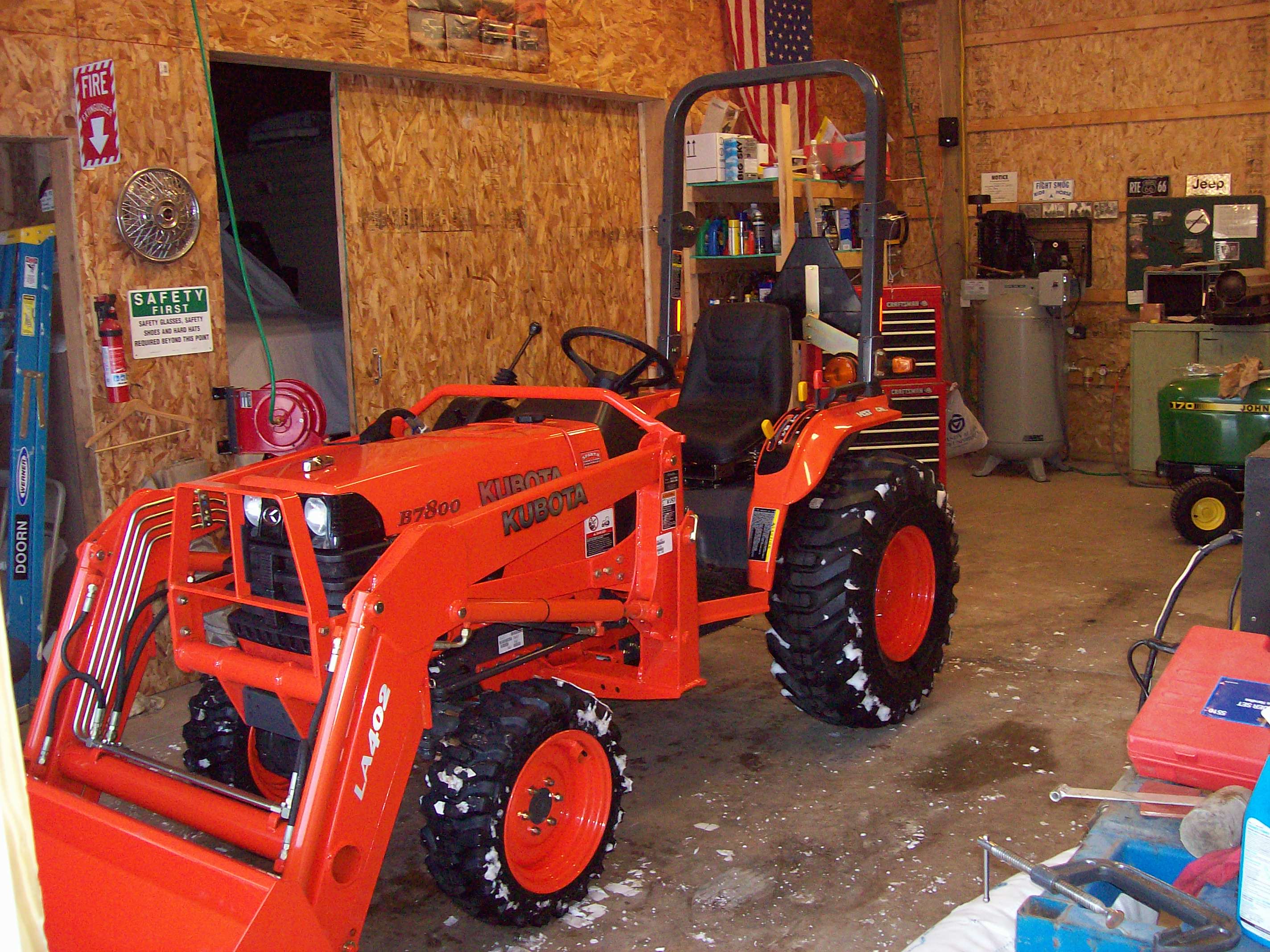

I looked at tractors for over 2 yrs! More than one good brand and the choices are many.
In my area kubota was the better choice for MY money! The b7510 or 7610 might be a good choice for you. JD makes some nice ones also. I've had alot of fun pushing snow around with the Fel this month. Good luck in the tractor hunting game!:D
