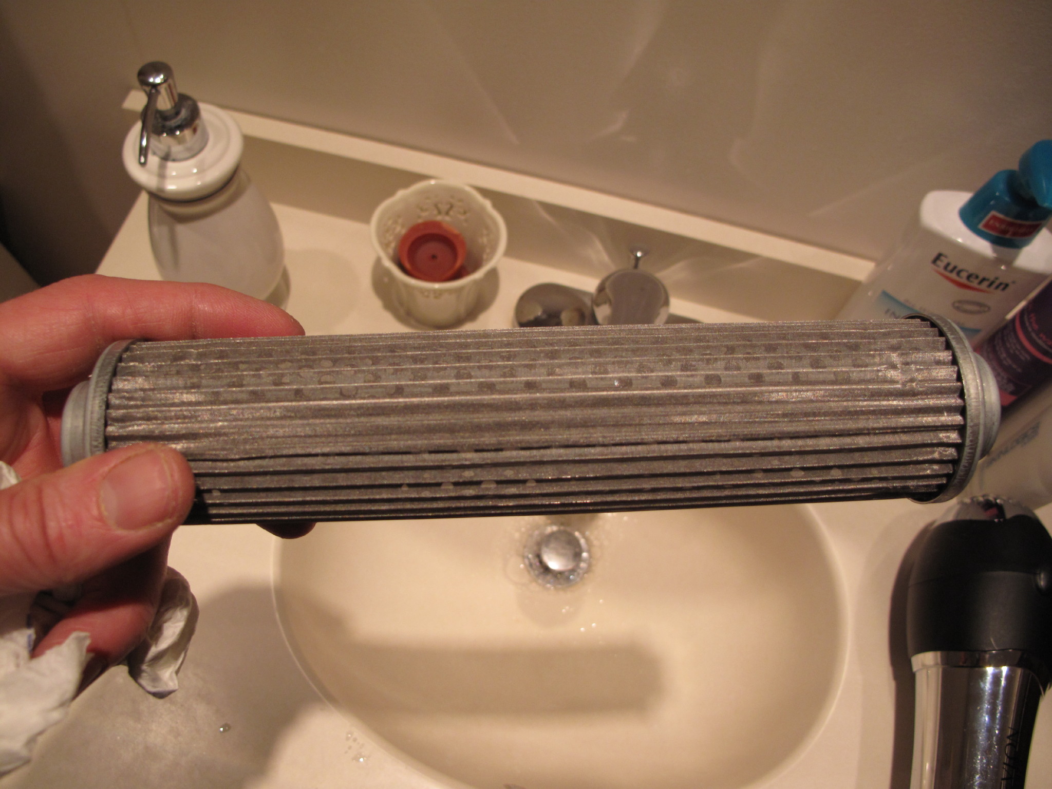

I ended up using Basic H and water and it did a superb job. You mix it with water and it is used for degreasing engines etc. it cleaned it beautifully. Then after rinsing it off I used a hair dryer and got it all dry. It looked brand new. I will post some pictures of before and after for you.
   / what solvent do you clean the Suction screen with?

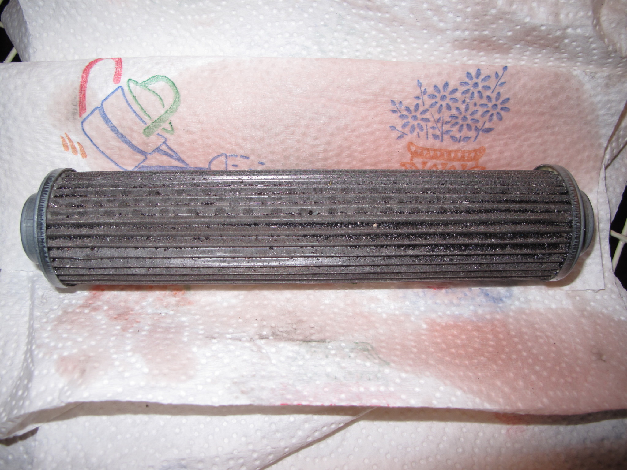

Ok here are the pictures.

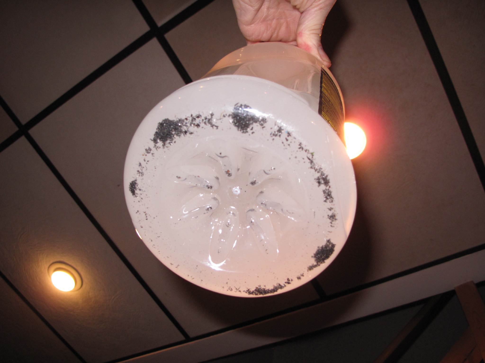

1. I bought this 2005, JD 990 TLB with174 hours on it and it looked just like brand new and it still does because I have only put 3 hours on it. The previous owner who purchased it brand new had changed the engine oil at 100 hours instead of the standard 50 hours. So it had been changed once in 174 hours. He had not touched the hydraulic oil and the manual states that it should be changed the first time at 50 hours as well but that did not get done. So I decided to change them. The JD oil for the transmission/hydraulics is no inexpensive oil. With filters and oil for engine and transmission plus a grease gun and 5 tubes of grease the cost came to a little over $200. The transmission takes 5.5 Gallons alone.
After emptying the oil from the engine all went normal as expected with the filter change and adding the 5.6 quarts of oil. Then it was on to the transmission/hydraulic system. I had sought to follow the manual and it tells you to use one of two drain plugs for emptying the oil. I used both since I had a nice big pan and I wanted to empty it as fast as possible. Once that was completed I removed the old filter and replaced it with the new filter. I removed the protective plate around it so that it would not get oil all over it when I removed the filter. It is only 3 bolts, 2 @ 13mm and 1 @ 12 mm. Then I removed the suction screen. After pulling the suction filter I found that it was filled with metal fillings on half of it and the other half did not look too bad but it had gunk on the ends. The manual said to use a mild solvent to clean the screen but does not suggest any. I searched on this forum and on the web and I could not find anywhere where someone discussed the solvent that they used apart from Carburetor cleaner. I really appreciated everyone's comments. At the end I used water with Basic H2. The basic H2 is from Shaklee. This did a superb job. I used juice bottle and cut the top off of it. Filled it with water and added the Basic H2 to it. Once that was ready i started dunking the filter and it cleaned off beautifully. I rinsed it quite a few times to make sure all the solvent had been removed and then dried it with a hair dryer. Once it was dry I put it back after cleaning everything around it thoroughly. I added 5.5 gallons of the low viscosity Hy-Gard hydraulic/transmission oil. Everything has worked well thus far after running it.
Thanks again for the advice. See the pictures which I took.
