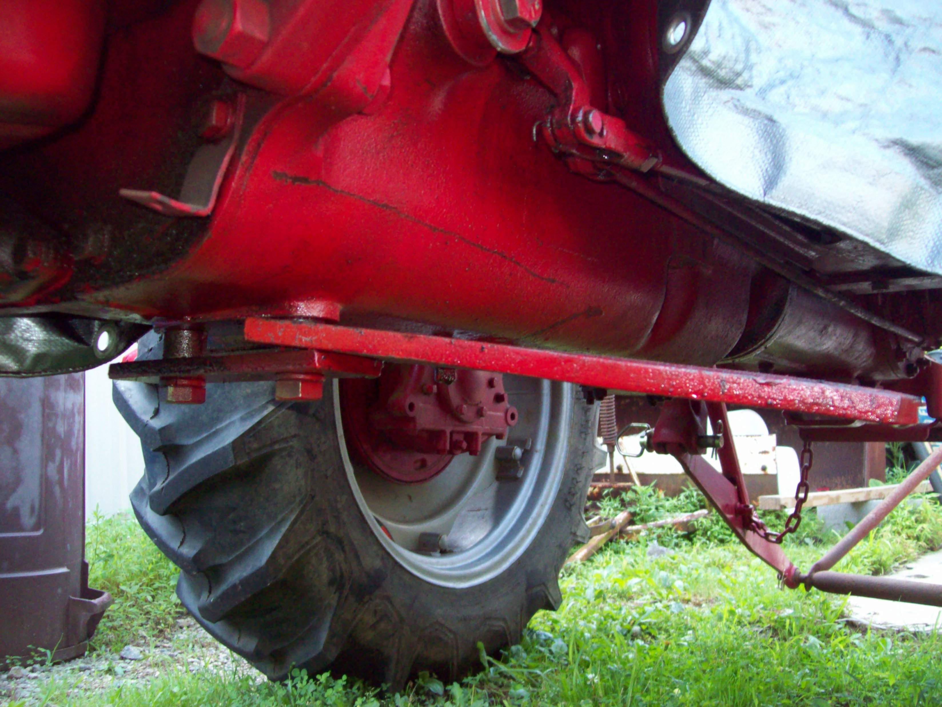

So I'm underneath the tractor and I see these four bolts just aft of the flange where the engine bolts to the transmission. They are on a flat part of the casting going athwartship (Side to side for you tractor types). I'm missing a bolt and nothing is leaking out, so I assume they are a mounting point for optional equipment. There are similar ones underneath the rear end. Am I correct or is it something else. I have tried to find exploded views, but none of the diagrams show these.
[URL=http://s998.photobucket.com/user/wtss1/media/IMG_0959_zpsaaxf1why.jpg.html][/URL]

It looks like bolt holes for a sub frame for a front end loader.

So a missing bolt is no big deal then.

Yup, mount points. A ford 711 or 722 loader for sure uses 2 of those holes

Here's a photo of the 711 one arm loader tranny mounts. Bolt holes are not hollowed out so if you take them out nothing will leak.

I suspect they put the cover plates on to keep the bolt holes clean, and to allow the bolts to bolt in without having to run a thread chaser in them when mounting a loader.
   / What the heck are these on my NAA #10
Those aren't plates, they are cast in boss .
