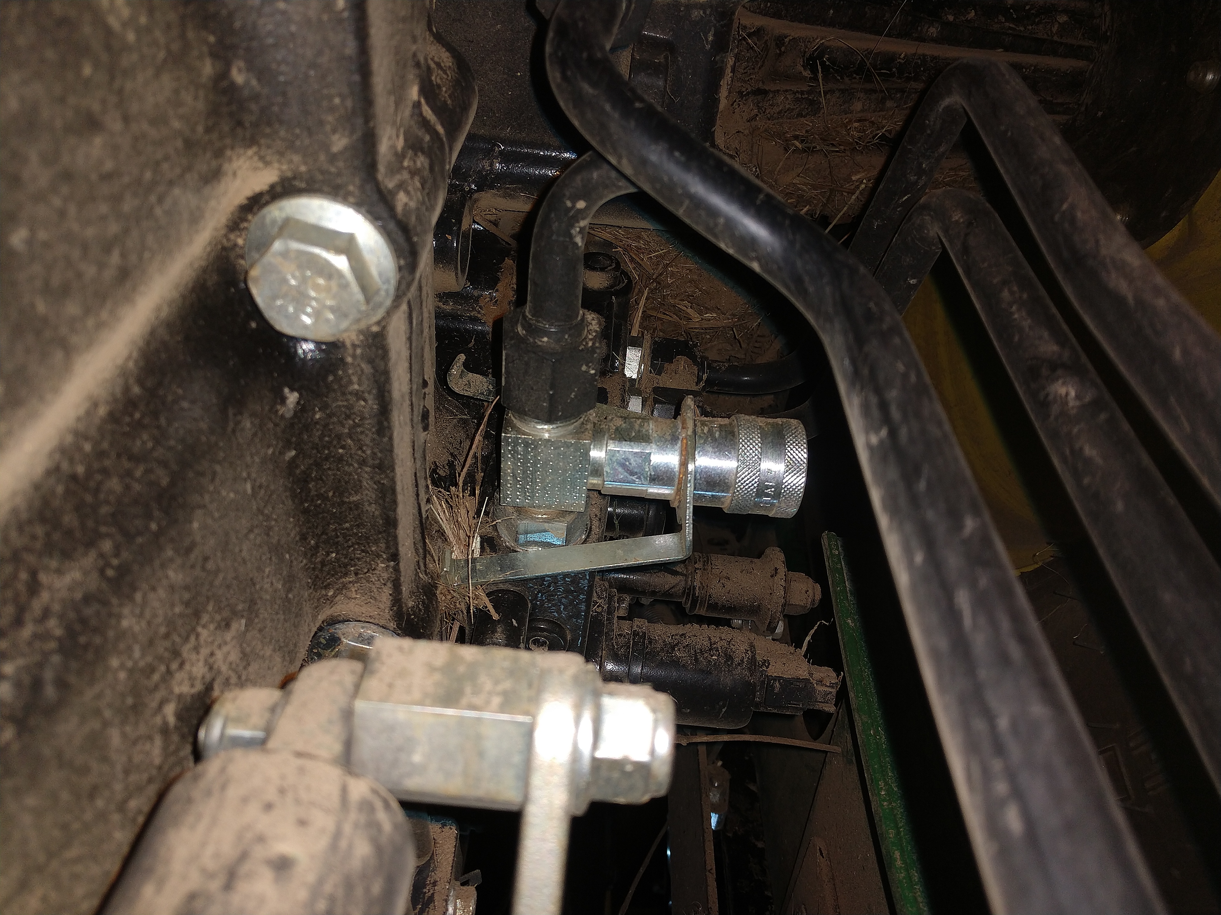

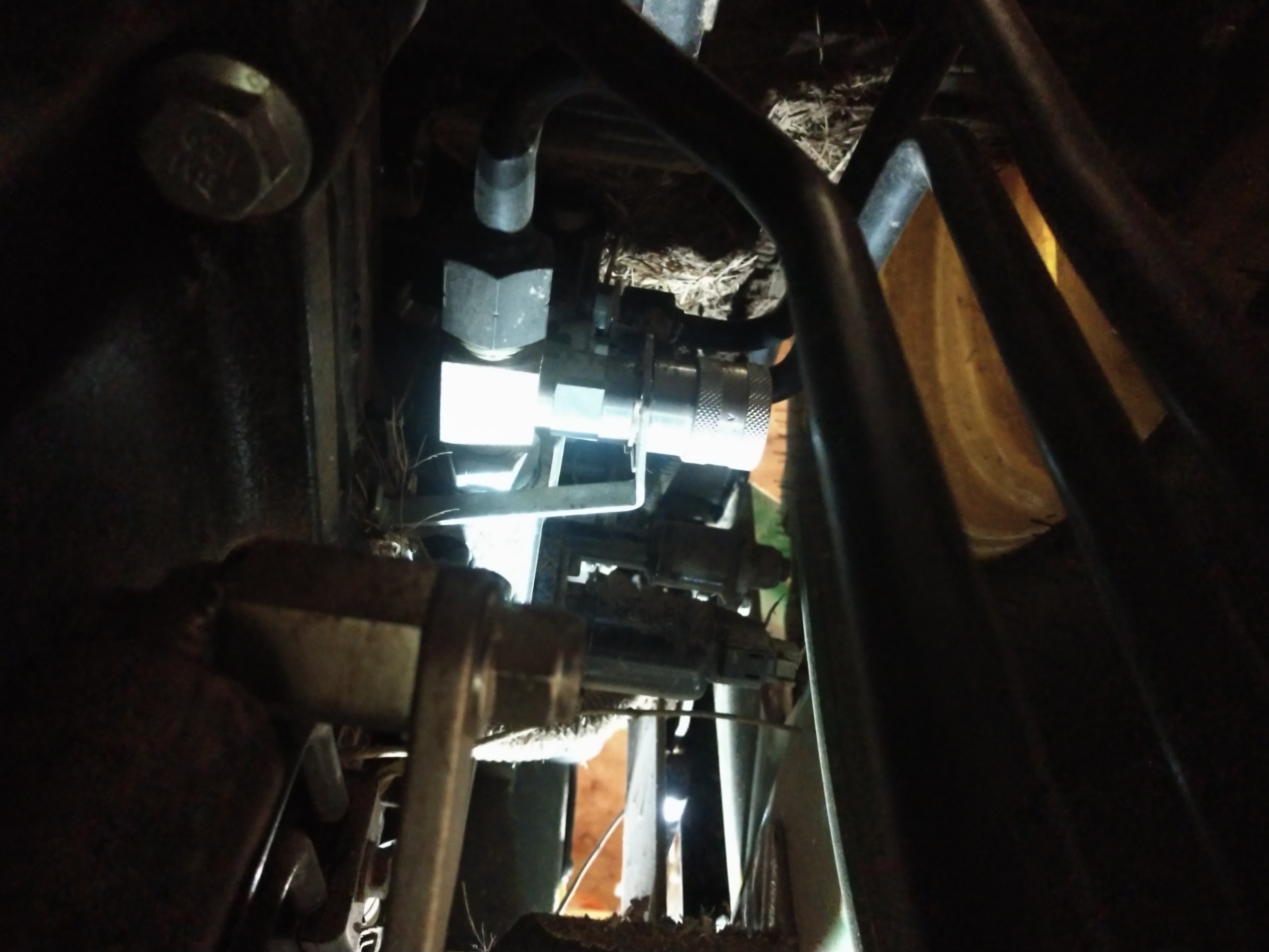

2018 jd 3032e
I was looking around on the tractor and noticed that there was a quick connect under the tractor which I cant seem to figure out what it would be for any thoughts would greatly help IMG_20191006_193035515.jpgIMG_20191006_193022385.jpg
   / What to add a 3rd function #2
A return to tank port. A direct return to tank line is required or at least recommended for various implement hydraulic functions.
