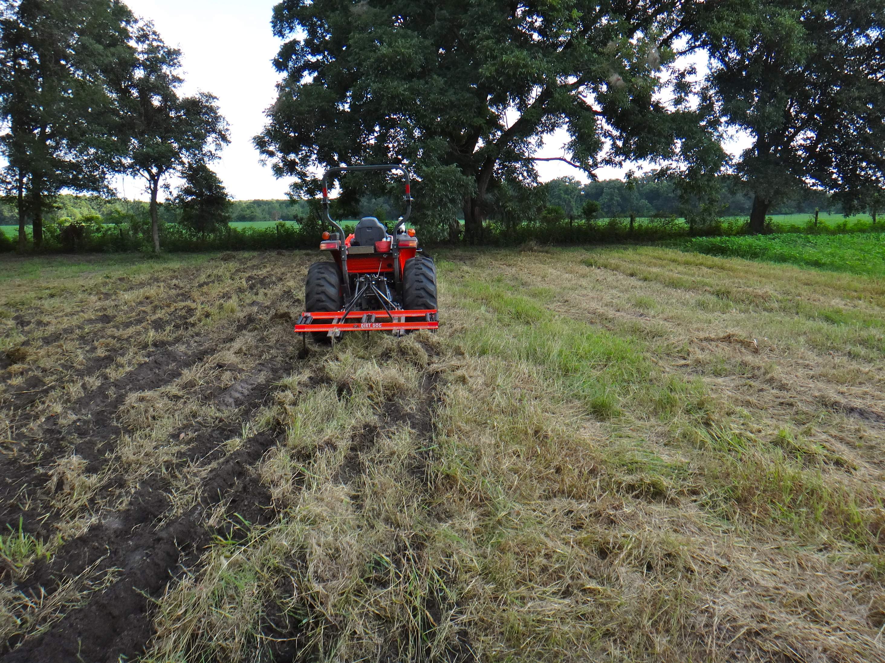

Disc Harrow is a Three Point Hitch implement best suited for long fields and tractors weighing over 2,500 pounds. For part of 5-1/2 acres better a PTO powered Roto-tiller which is easier to use in confined spaces. Disc Harrows AND PTO-powered Roto-tillers are both soil mixing and soil leveling tools. They produce the same result by different means. Unlikely to cut through horse compacted soil layer.
The horses have probably packed the paddock so tightly that water cannot perc.

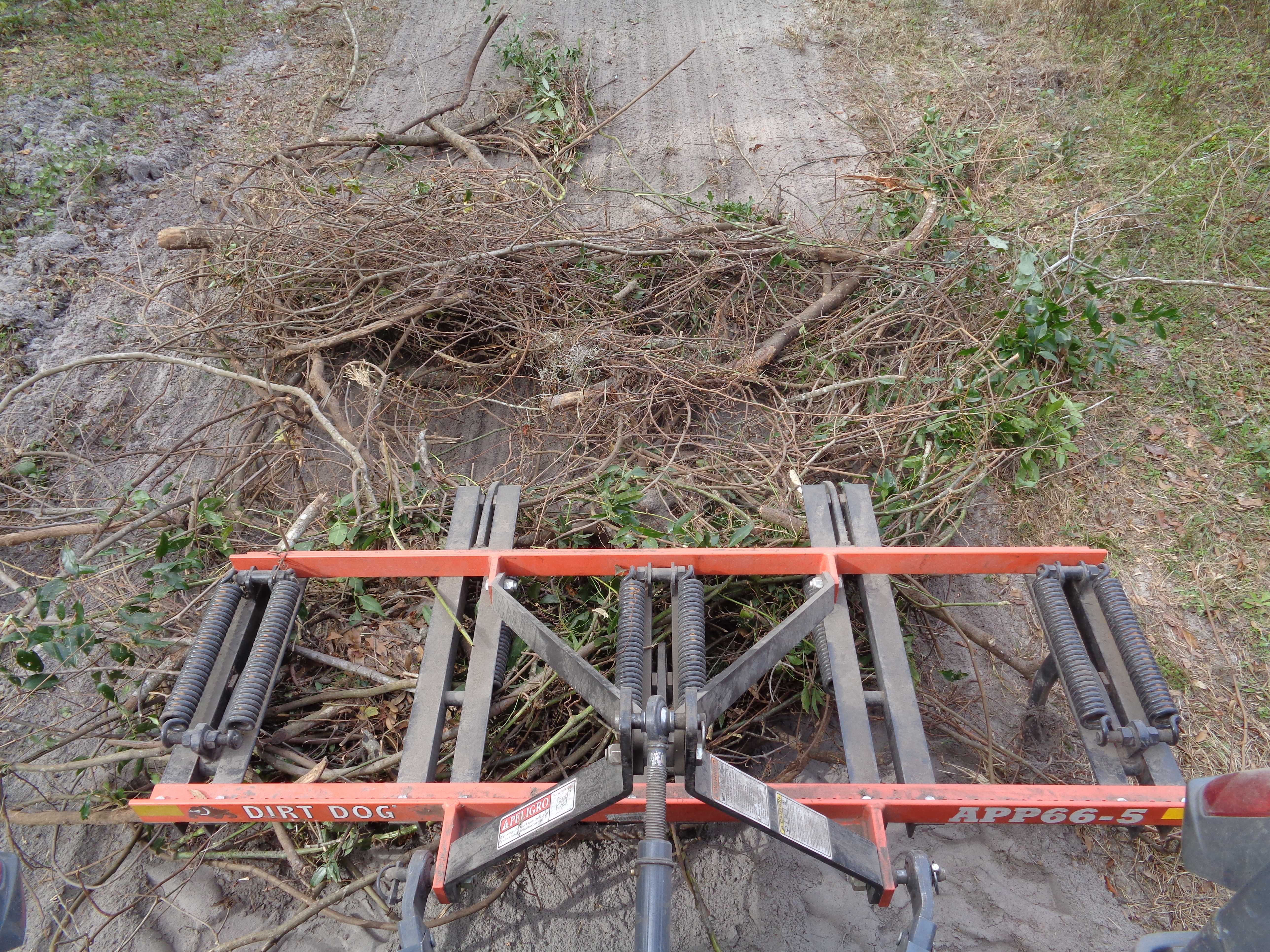

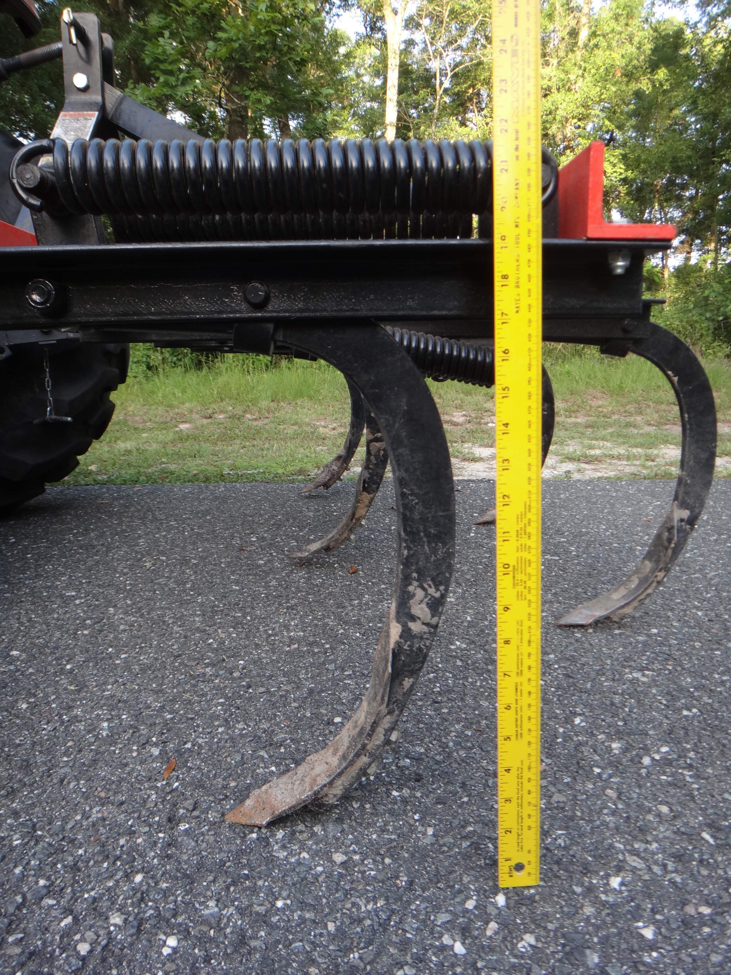

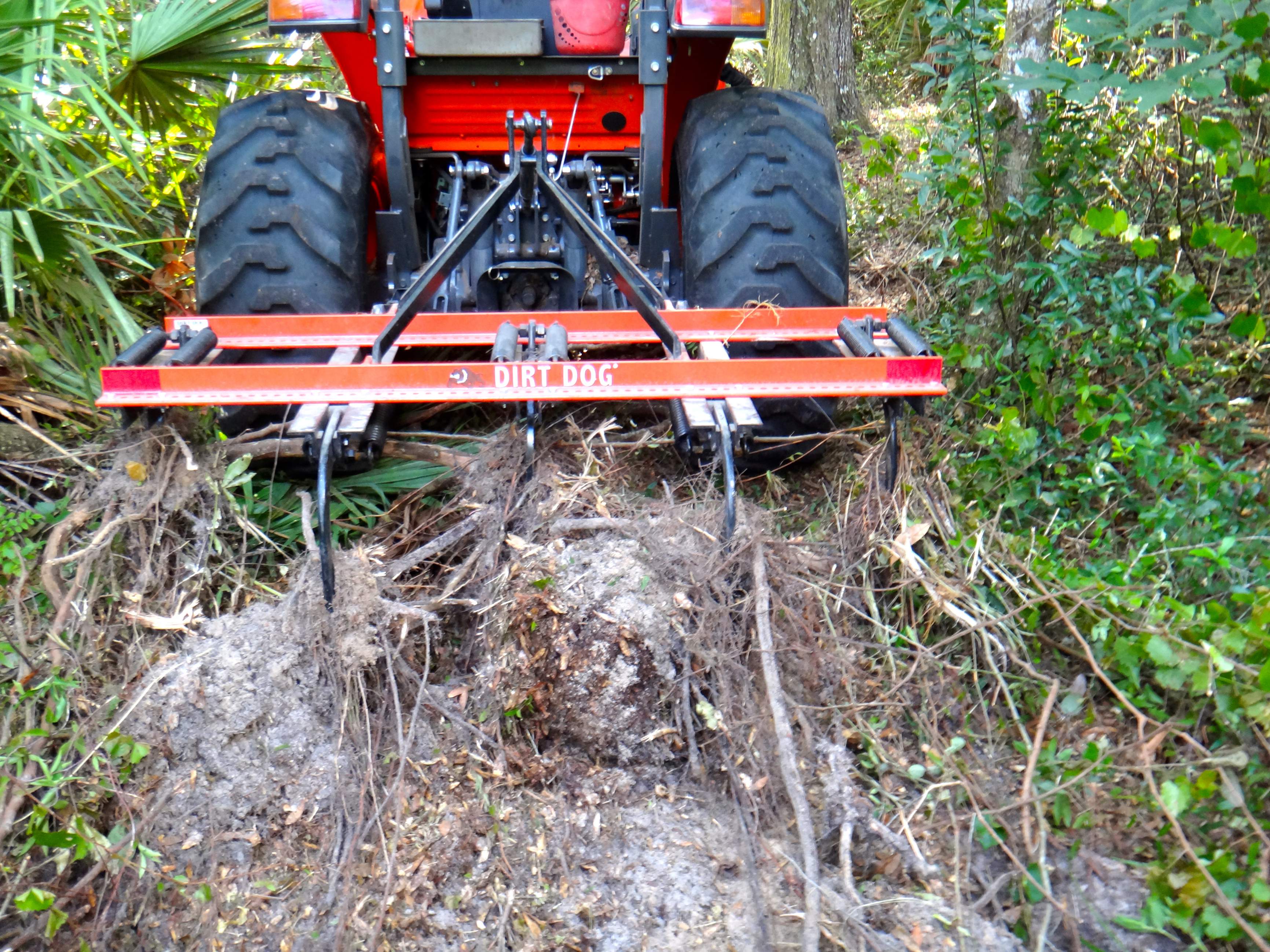

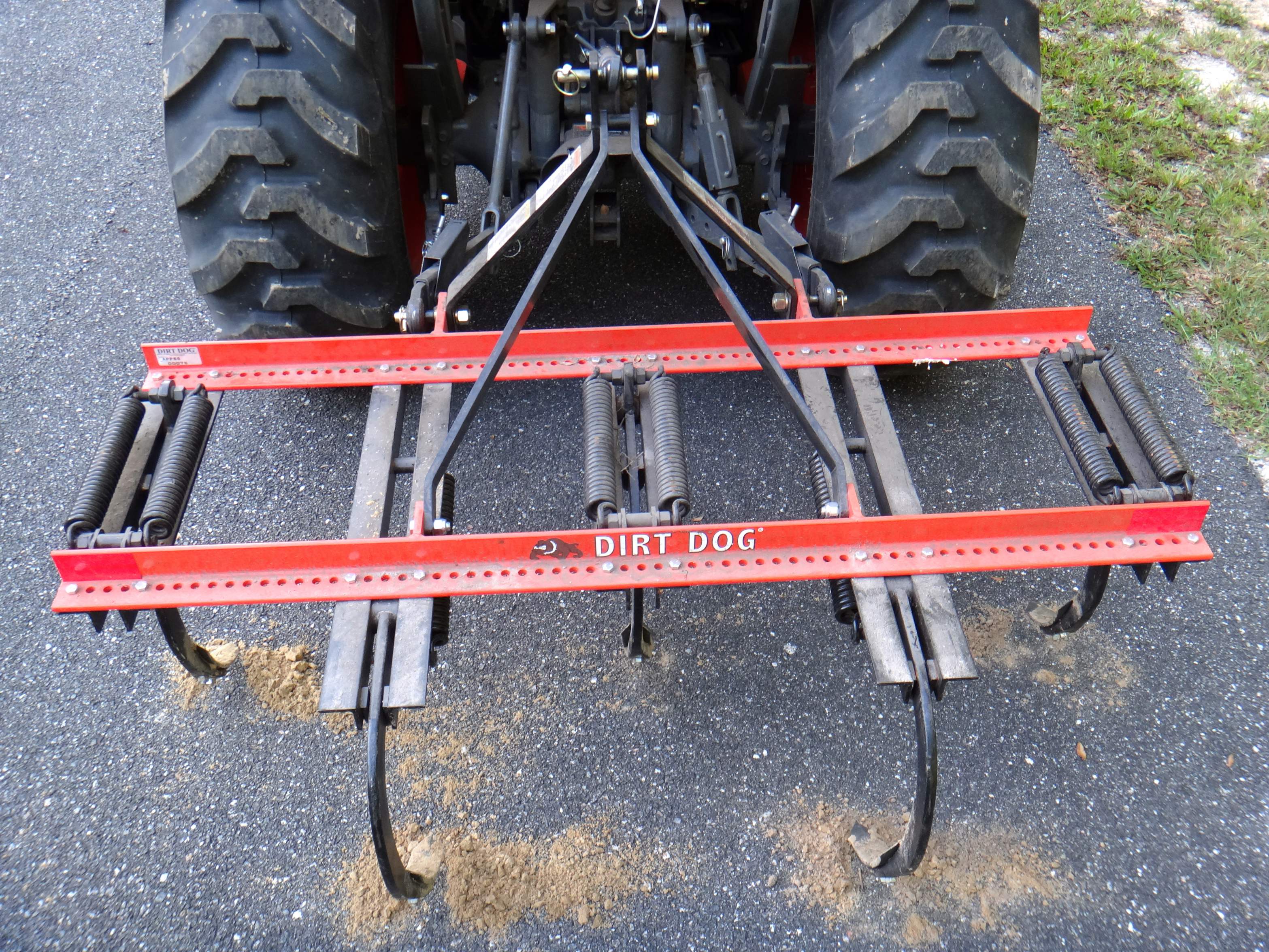

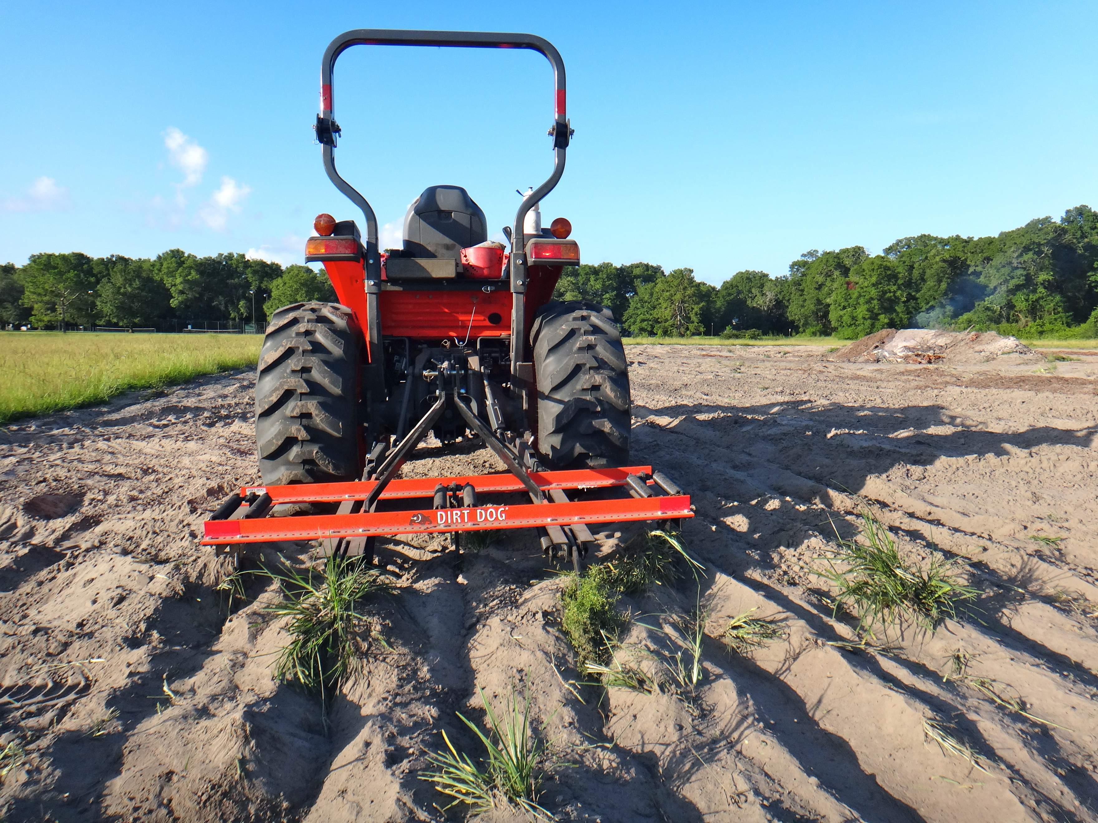

Three implements suggest themselves, a spring-protected Field Cultivator which can penetrate to 14", below horse compacted layer, a Subsoiler which can also penetrate to 14" but is less versatile, lastly a Middlebuster, AKA a Potato Plow, which can penetrate 6" to 10". All are suitable for tractors weighing from 1,700 pounds bare tractor weight to 4,000 pounds bare tractor weight.
Field Cultivator AKA All Purpose Plow - Often used for periodic pasture aeration. Good for tearing out tree roots, vine roots and corms from underground, then transporting debris to a burn pile or compost pile.

L3301 will pull a five-tine Field Cultivator, which remains my primary recommendation to alleviate your wet conditions likely caused by soil compaction. Field Cultivator will not kill grass still alive.
MORE: http://www.tractorbynet.com/forums/attachments/339095-dirt-dog-all-purpose-plow.html?highlight=
