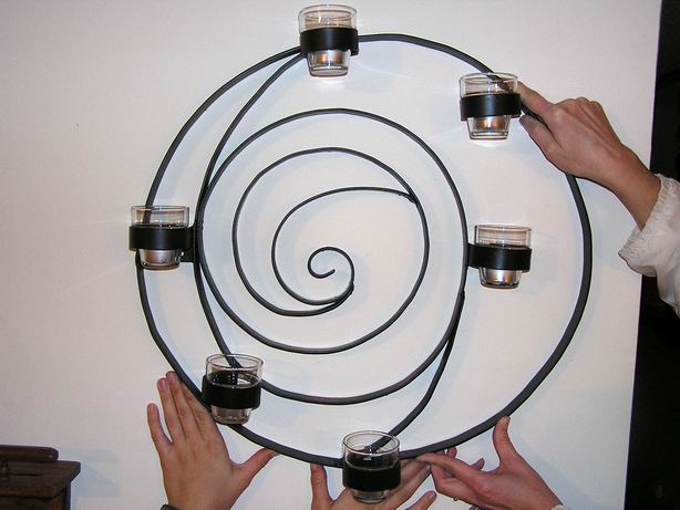

Welder & supplies is round one. Round 2: Autodarkenig helmit will make it SO MUCH easier ($60), Cut off saw ($150), harbor Frt metal bender and scroller ($100), Small pedestal grinder ($40), 4" angle grinder ($15-$80), Oxy-acetylene setup if she's doing thicker stuff (or you need it for your tractoring!).
Access to surplus iron and a means to haul it (pickup), plus a place to store it inside to avoid rust.
POR15 or your favorite converter to convert rust to stable something. Krylon to suit.
Lifetime of enjoyment. Daughter came home for spring brk and wanted to make a candleholder. I already had most of the above stuff, so she spent a day bending/unbending and shaping her candleholder. We had a blast together. I welded most of it, but she did some of it.
It ain't gonna win any prizes, but she likes it, and we've got maybe $20 in materials in it, not counting the tools or time.

The kind of work in the picture of candles would be way more suited to a wirefeed. It's like a hot glue gun of metal.

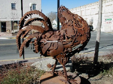

</font><font color="blue" class="small">( WELDING ART??? /forums/images/graemlins/confused.gif /forums/images/graemlins/grin.gif /forums/images/graemlins/laugh.gif
Not sure what that is or how to do it ...
)</font>
Here's some welded art, Mike the Headless Chicken in Fruita, CO

That turkey needs some rustoleum /forums/images/graemlins/grin.gif /forums/images/graemlins/grin.gif
