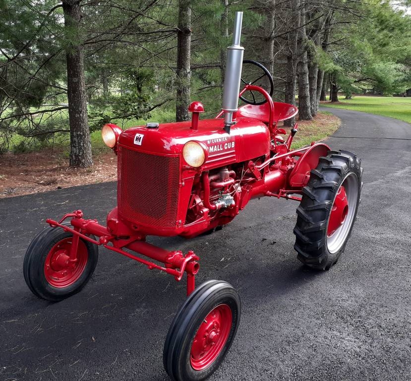

I recently bought a 1949 Farmall Cub exactly like the one my grandfather bought new. The owner restored it, lived 5 miles away, and had a huge binder of receipts just parts more than I paid. It's really just a novelty.
I think accurate hours are extremely important, or at least expert estimation.
